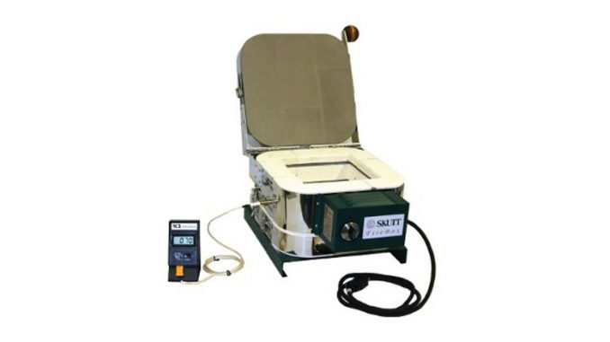

I have a small Skutt firebox kiln with a low/Med/hi setting and that’s it! When using this small kiln is there a trick to fusing and slumping small items? – E.G.
Jewelry sized pieces are pretty easy to fire, even without a controller. Just start slowly, keep an eye on the kiln to avoid overfiring, and let it cool naturally.
Start by loading the kiln, making sure to center your glass pieces inside, in the middle of the shelf. Turn the dial to medium and heat until the temperature reaches 500F/260C. When that happens, turn the dial up to midway between medium and high and continue heating. When the temperature reaches 1000F/540C, turn the dial all the way to high. Watch carefully until the piece is fused the way you want. Then just turn the kiln off and wait for it to cool.
