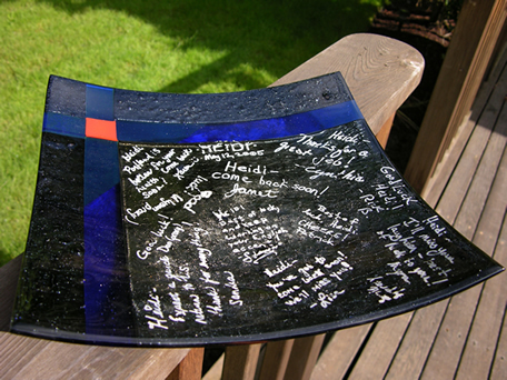

If you're into casual with the nametags, get a marker and write them on the bottom glass, cap it with clear and fire. I've had good luck using the Brite-Mark Valve Action Paint Marker (Bullseye sells it--it's the white stuff they mark their glass with). I'll cut a thin sheet of silver or gold irid on black, round over the edges (so nobody gets cut) and then have everyone sign it, as in this farewell present for one of my employees (below). I usually ask them to write it once (you'll need to supply a practice sheet of glass because it takes a little practice to get the paint to flow well), let it dry for about 5 minutes, and then carefully go over it again. Or I'll go over it again--you really need two coats for it to be strong under the glass. Then I incorporate it into the piece, cap it with clear, and fire in a low-to-normal flat fuse.
Signed dish with Brite-Mark
On white or light colors, I've done the same thing with a Pilot Gold Marker. It turns dark brown. I've also bought a Krylon 18Kt gold pen that I'm told will stay gold, but I haven't tried it yet so can't say for sure.
