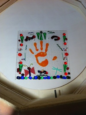

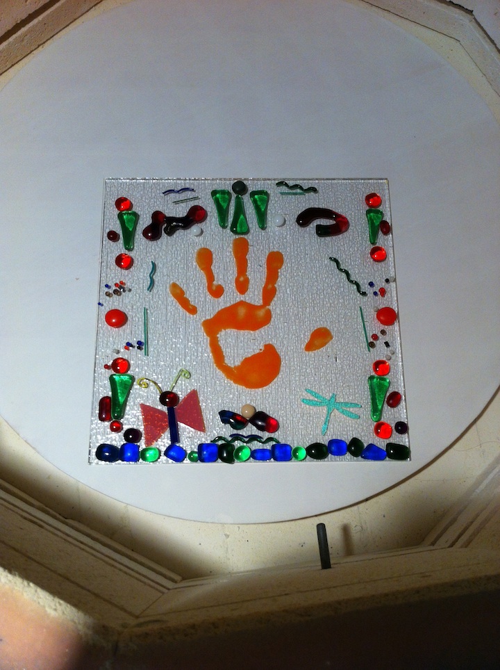

My five year-old niece was here in April and wanted to work in glass. I did her handprint with Barry Kaiser's pre-mixed enamel paint. It was fired on top without a cap and while we did lose a little color, it was ok. This was orange paint, with the photo taken before firing the piece:

Valerie Adams wrote:My five year-old niece was here in April and wanted to work in glass. I did her handprint with Barry Kaiser's pre-mixed enamel paint. It was fired on top without a cap and while we did lose a little color, it was ok. This was orange paint, with the photo taken before firing the piece:
hi valerie,
thanks for posting your pic
your grandson's hand impression is adorable. you seemed to have got a good even coating, colour, and impression! well done!!! did you use kaiser paints? i took some impressions today, but still haven't fired them.
