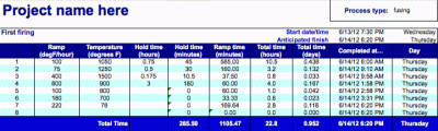

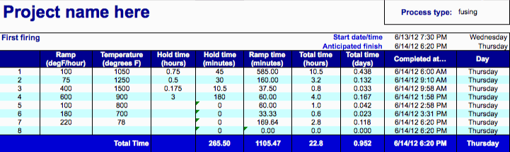

Are you sure you're not miscalculating? I ran your schedule through my spreadsheet tool and came up pretty close to Stephen's schedule. (Mine's a bit shorter, I think because I was starting from 78F):
I have you reaching the 900F anneal point around 11AM, give or take some time, which isn't too far off from what you observed. It sounds as if your other firings go much faster--are you sure they're the same schedule as the slowpoke? Obviously I don't know what kiln you're using or how fast it spills heat--in one of my kilns this schedule would run maybe 8 hours longer because it's very, very good at holding in heat.

Cynthia, thanks for the spreadsheet check, what a neat idea. My other firings do seem to go faster, but there are variances in the setup and design. I need to do more monitoring and comparing of schedules to like work and making better use of inf. in my notes. My kiln is an Evenheat 23". I Stephen I apologize for thinking my calculations were more in line. Susan, I hope it's not the relay, but I do have spare relays and a new element on hand.

No prob. I set up the spreadsheet several years ago, mostly for casting so I didn't have to keep getting up in the middle of the night to close the vents. The spreadsheet lets me play around with the schedule so that I can pay attention to the kiln at reasonable hours. ;-)
