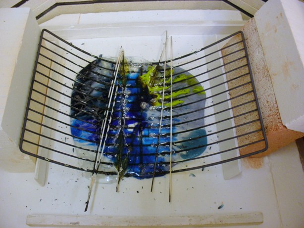

Attached is the photo of my first and only mesh melt............
A complete disaster
I bought the net as SS, which is evidently not the case. At 600 c. it began folding, and at 927 [1700 F.] it was inside the glass down below. I told myslf I go thru the whole process, and see how I would deal with it after apropriate annealing, it should be toatlly wasted.
It is not yet cold enough to get it out of the kiln, even though its quite hot here
Please note, that it also pushed the bricks...
What do you suggest, how would I break it? Just use a hammer?
There are also flakes of the silvery coating of this supposedly SS,
But I have to say that there are some nice results there, and I'd like to repeat this process ASAP.
Once I take it out of the kiln, I'll first start a new one, and only then - go back to this one and deal with it.
Your comments will be GREATLY appreciated,
many thanks in advance

Were the 5-6 rods visible in the image originally there to help arrange the glass pieces before the melt? Did they perhaps roll around when the glass started melting and allow the volume to shift towards the center while the rack was beginning to fall in? Not sure that has anything to do with the frame collapsing in the first place, though.
That frame looks like an oven rack - was it? Do you know the type of SS it was made from? E.g., 316?

David Jenkins wrote:Were the 5-6 rods visible in the image originally there to help arrange the glass pieces before the melt? YES Did they perhaps roll around when the glass started melting and allow the volume to shift towards the center while the rack was beginning to fall in? I think so Not sure that has anything to do with the frame collapsing in the first place, though. ME neither, I simpley think that this is not really SS
That frame looks like an oven rack - was it? YES IT IS - but it was sold to me being SS...Do you know the type of SS it was made from? E.g., 316? Unfortunately I do not know
I have an additional question, I have some strips of SS, they are about 1 c'm wide [1/4" ???] and 1 m'm [about 1/32" ???] thick. Do you think that it will or will not bend at the temp of 1700F ???
Do you think that those rods can be a part of the mesh, or will it collapse again?

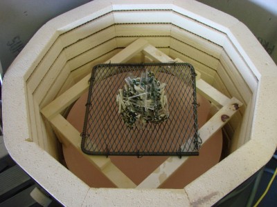

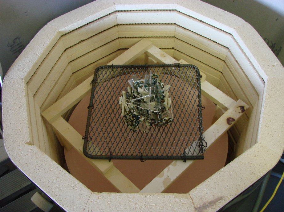

This setup never fails. The rebar is cheap.
Georgia Novak
Posts: 28
Joined: Wed Jun 04, 2003 2:54 am
Re: MESH MELT DISASTER
Post by Georgia Novak »
Jim: I see the re-bar but do not know what the mesh is. Is it SS? If so where do you purchase it? Thanks, Georgia

I can really empathize with you on this as I had a similar disaster with my first wire melt attempt. The set up I use now is very similar to Jim's, although mine uses SS wire mesh that is made up of interlocking wire that creates square openings. I can't comment on whether the sagging you experienced was as a result of the material your rack was made from, but I think part of the problem was it was made up of parallel rods that had no perpendicular supports. When you added the weight of the glass and heat, the resulting leverage probably caused the bending. Jim's set up, which is a lot like mine, uses mesh that is supported all the way around the perimeter and is anchored to a stout frame. This is really important because even if you support the wire all the way around, it can bend off into the kiln unless it is anchored to the perimeter support in some way. Mine is welded. I think Jim mentioned in an earlier post that his is secured by additional wire.
I posted some details on my set up a little while ago. If you'd like to PM me, I'm happy to share the specifics with you.

The Hobbyist
Posts: 308
Post by The Hobbyist »
The mesh is expanded metal. It is not SS so it spalls and will sometimes leave some metal in the melt. I tried SS once (a BBQ grill) and it spalled the same as the metal mesh only it cost a lot more.
I can buy the mesh at my metal club. I get a 4' x 8' sheet and cut it into (32) 12" x 12" squares on the big hydraulic shear. I get the rebar there also. A 20' piece gets cut into 5 48" pieces that bend into 12" squares. The mesh is attached with bailing wire twist-ties, Each assembly costs about a buck so I can through them away after each use.

I had to look twice at your setup, Jim. At first glance that looked like kiln washed 1x2 wood strips with the knots showing on the end in the upper right... and that didn't look like a wood fired kiln. :D
Mike
The Hobbyist
Posts: 308
No, those are some of my dams made from salvaged kiln shelves. Many times they are from ceramicists and what you see as knots are glaze drops fused to the shelf before I cut them up.0

Jim
I have been looking at what you do. . Excuse me if I am asking stupid question - your 'frame' so to speak is not connected to the mullite [kiln shelf] frame , only laid on it, am I right??? Or else, how is it connected to the 'kiln frame'?
