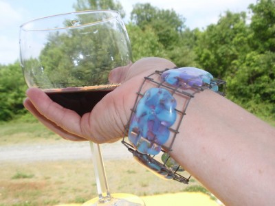

Construction fabric is galvanized, and usually, it all burns off in one firing. Then it can be encased in Bullseye Glass. I have switched to sandblasting the coating off, or soaking it in vinegar/alcohol solution. Less dangerous to ozone.
