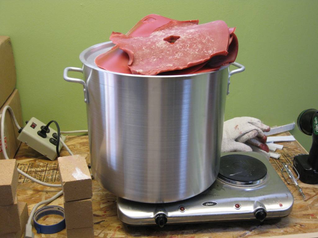

Put a couple inches of water in a pan, place your mold above the water using something like shelf posts, boild the water and steam out the wax. I like using a big pot with a lid. Some people fill with glass at this time and include their drying schedule in the ramp up. I prefer to dry my mold and burn out the wax before I fill the mold with glass. I have a friend who uses an old barbque and places his big pan of water on that and closes the lid while the wax steams out.

If your wax has a petroleum base (such as brown "victory" wax) and your kiln is in an enclosed space with limited ventilation, do NOT burn it out. The fumes are extremely acrid. I did a kiln burnout in my studioexactly ONCE with a mass of victory brown--experienced extreme respiratory distress, burning eyes, etc., and spent the rest of the day airing out the house. The smoke leaves an oily brown deposit on everything, which stains cloth and is a pain to scrub off.
You can torch wax out in an open, well-ventilated space (i.e., outdoors), but be careful if your mold is plaster: When the flame touches the mold plaster it can rapidly evaporate the water and open cracks in the mold, rather like a dry lakebed. It takes a bit of practice to aim the flame only at the wax and avoid the plaster.
Glass Hole's method works well, although it helps to direct the steam to the wax and not to the whole mold if you're removing a lot of wax. Otherwise, you risk saturating the plaster and turning it soupy, which can weaken the mold, cause loss of detail and sometimes makes the surface of your glass scummy.
I started out steaming by buying an old used spaghetti pot at the Goodwill. It worked well for smaller pieces.
For bigger pieces (that wouldn't fit in the pot, which was most of them), I drilled a hole in the lid, got heat-resistant tubing (actually, I found an old clothing steamer hose at the Goodwill), and pushed it through the hole. I filled the pot with water, put the lid+hose on the pot and duct-taped the entire assembly together. Then I bought two big galvanized washtubs and a stainless steel rack salvaged from an old oven. I put the rack on the first washtub, put the mold on it, stuck the hose in the mold and then covered the whole thing with the second washtub. Steamed the wax out pretty quickly without messing up the mold. The wax drips down into the bottom tub; if you put a little water in the tub before you start it never sticks and is fairly easy to remove.
Now I've got an old wallpaper steamer (also bought at Goodwill for about $15) that I use in place of the spaghetti pot.
One other tip (which I learned from Mel & Les Israelson): Make your waxes hollow for anything larger than jewelry-sized pieces. The wax steams out in a fraction of the time and is much less damaging to the mold.

How big is your piece. Do you have access to a wall paper steamer or pressure pot. The wall paper steamer is best as it has a long hose . Cut a hole in a piece of wood that will accept the hose. Set it up on a rack over a container that will capture all the dripped wax. Make sure once the wax starts to run it has somewhere to drop all the wax into the container below. Also good advice is to cut 2 strips of wood that is 1/2 an inch higher than the wood with the hole so your mold sits up abit higher than the piece of wood to keep the top of your mold nice and clean.
Place mold on the wood which is suspended above the container to catch the melted wax and water. (make sure the hose is pointing straight up and at least 2 inchs into the mold itself. If you have to , secure it there with wire so it does not move when hot and pumping out steam. NOW cover whole thing with black plastic bag. Also put a blanket over to really keep the heat in.
Once the mold is truly HOT (by feel) and NO MORE WAX is coming out!) you can cool it down by unplugging the steamer AND take blanket and plastic bag off. This can take anywhere from 10 minutes to 2 hours depending on the size and shape. Do not worry, the mold will stay together. BUT let it cool. If you are worried about wax in pockets, do as my friend Cynthia suggests and pour BOILING water into mold and all the wax should rise to top. But once again waite until mold is cool . Be very careful with the mold also.
