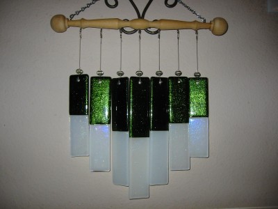

bothofushk
Posts: 42
Joined: Sat Jan 22, 2005 3:10 pm
Location: East Texas
Re: Drilling or Adding copper wire???
Postby bothofushk » Mon Dec 10, 2012 3:40 pm
Hi all,,I am uploading of my chimes I made for a client...very normal not very artistic but pretty none the less and they sound great..dont know whether I will continue to drill or not..thanks for looking
