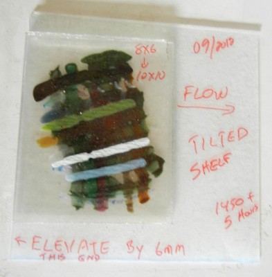

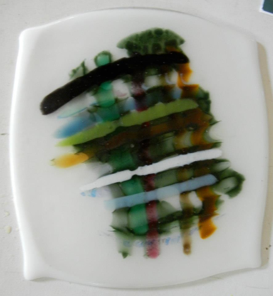

Here is one example. Lay up is on one 10 X 10" piece of 3mm translucent white. The stack is a total of 12mm of 8 X 6" of glass. Many things are going on here, including travel, but the goal is to get the stack to stretch to the size of the transparent white.
AFTER
BEFORE

I don't see the break or shatter. What is the white in the middle of the coloured glass?

Steven, this is not the thin opaque. It just shows my method of stretching. I don't have photos of the thin opaque failures, but they were stretched the same way. The design in this piece is trrips of factory glass, stacked like a plaid, and stretched out to 6mm in thickness. It is sandwiched between pieces of 3mm clear. The goal was to get it to stretch to the size of the base glass, with a finished piece being 6mm.

I notice the notes on your photo of a top-temp of 1450 deg. F. with a hold of 5 hours. Are you ramping up at 200 deg./hr., 300 deg/hr.? ,or maybe higher? If the cracking isn't coming from the ramp up, or the annealing schedule, nor because the spreading glass is sticking to the shelf as it crawls across, then it's perhaps a compatibility issue. But if it's all Bullseye compatible, fusing glass, then a 5 hour hold at 1450 (assuming it's the first, and not a repeated lengthy hold) shouldn't be too excessive and put any strain in the glass (assuming appropriate annealing sched.).
