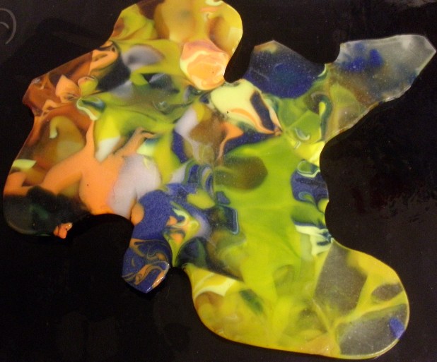

Hello every body,
So I made another melt.....
I want to do strip fusing around it and have a complete piece.
The piece's size is 27c'm by 23 c'm, 6 milimeter thick.
I would like to go again as high as 1700 degrees, as I like the way the glass becomes at this high temp. My hesitation is whether it will not have bad effect on the melt - by taking it again to such high temp.
Anybody with experience in this? Should I take the risk, or not?
as usual, many thanks in advance,
Re: REFiRING MELT ON HIGH TEMPRATURE
Oh dear, I am not sure Havi to take such a chance . It is soooooo lovely now. That is really hard on glass. Les
AmySkewed
Posts: 11
Joined: Fri May 12, 2006 12:53 pm
Location: Chicago Area
Post by AmySkewed »
I have taken pieces up that high for multiple firings. As long as they didn't color shift the first time I have not had a problem. However the piece will flow along with the new glass you are adding so it will change. I am confused on what you are trying to do as an end result.
