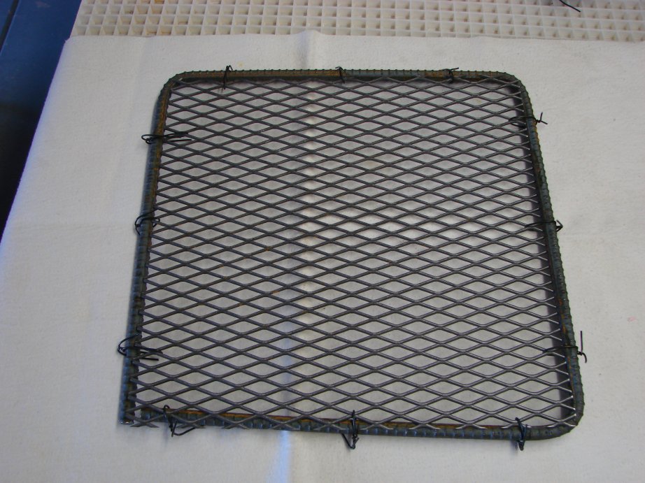

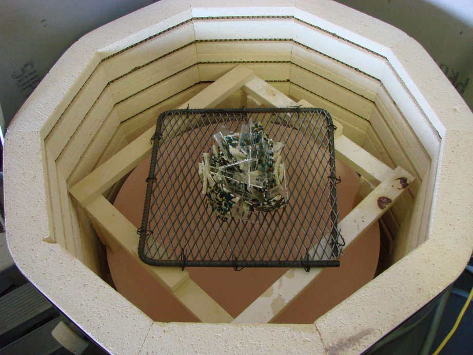

If you put the screws into the top edge of the vermiculite and don't bend the SS mesh over then I would expect the weight under heat to pull/rip the screws out of the vermiculite. It may all fall into the middle.
Jim
ps. Here's how I set it up:
