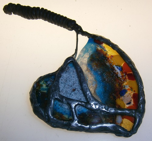

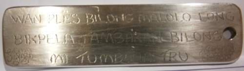

Haydo
Posts: 292
Re: Adding cremains to already fused piece?
Post by Haydo »
This thread has had me on a hunt, not for long but still the same it's a shame that something special personally can be tucked away without much thought until prompted. Still kniave with glass but this was done back in '99 before a solo trip to PNG. Grandfathers ashes in a talisman, it spooked some of the locals there at the time especially with the shattered pigeon english tag stating that the grandfathers spirit resided in it. It's obvious that the piece was salvaged from a bigger disc, it is close to 10mm in thickness so there were a few issues that a novice was still coming to grips with. The ashes were layered on top of frit which was placed on a base of clear sheet and capped with clear sheet. What I like about it is that there is a pin prick of a hole through the ashes that has an orange/amber glow when held to the sun. It is a chaotic bit of work.
peace, haydo
