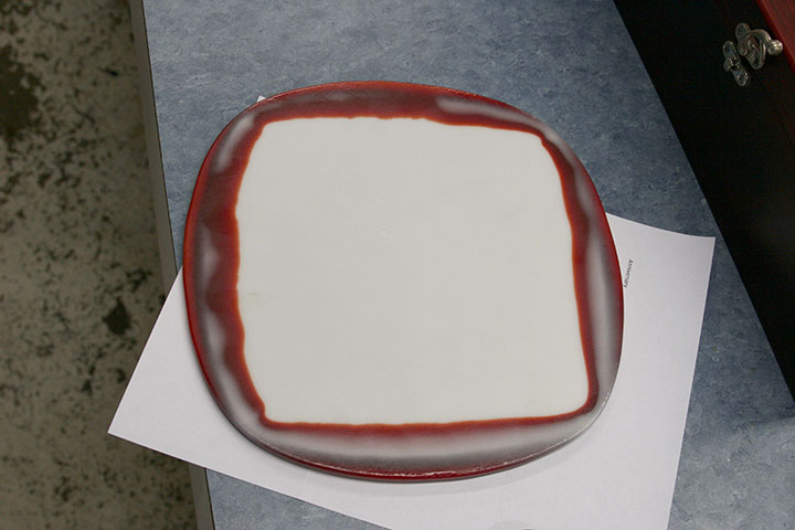

Hey Paul, got an inquiring mind when something captures my interest. Was thinking about your thermal mass problem along with why you can't just make a retaining ring with a 31cm diameter retaining ring/dam and just cook until you get dam full, making sure that the shelf is very level. But if it is to see the result of what happens by pressing, I'd be inclined to use IFB's to give weight to the cause as these could be removed after pressing and the top shelf maybe could be propped away from the glass. The initial surfaces of glass touching the shelves may not shift much either, I'd guess that all the movement would be from within the two surfaces. peace, haydo
Re: compressing glass
Haydo-
You are right on the money. The insides squish out / move much faster and further than the top and bottom.
Here are a couple of photo that show it. 4 - 1/8" layers between two shelves.
Guy
Guy

Very cool, Guy. Is the "bird" screen printed?GuyKass wrote:Haydo-
Guy
Thanks. One of the zillions of things I start and never finish around here.
Actually it's etched/sandblasted/carved, whatever one would prefer to call it.
I vary the thickness of glass by varying the layers, etch through them and then (usually) fuse back onto clear to the desired thickness.
I'm dying to roll them up and make vessels. Just never enough time or money.
Sort of a poor man's Graal.
Guy
