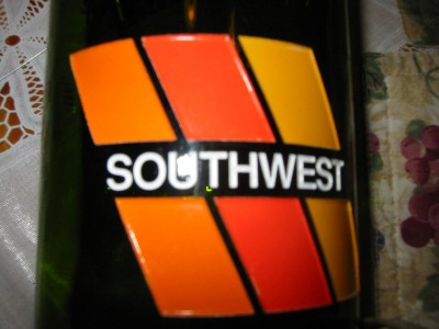

Hi all,,,is a picture of the bottle I was asking about,,I did the scratch test,,and indeed it did scratch..
so that means it will burn off right?
Re: another Bottle Slumping Question
Yes. It will burn off.
I do lots of bottle etching, and that is a classic example of regular old paint.
I would bet anything on it.
Now if you want to reproduce, it...
You can etch a flattened bottle and color fill it with enamels for Brad or Thompson or someone like that and it will work.
Guy
ps If you want to try it from scratch, feel free to call me and I can talk you through it.
Hi again-
Upon reflection I was making it harder than it had to be (if you knew me you would know just how shocking that is.)
Anyway you could slump a regular bottle, etch it, and color fill it with regular enamels (like the existing bottle), no reason to put it back into the kiln again.
Guy
