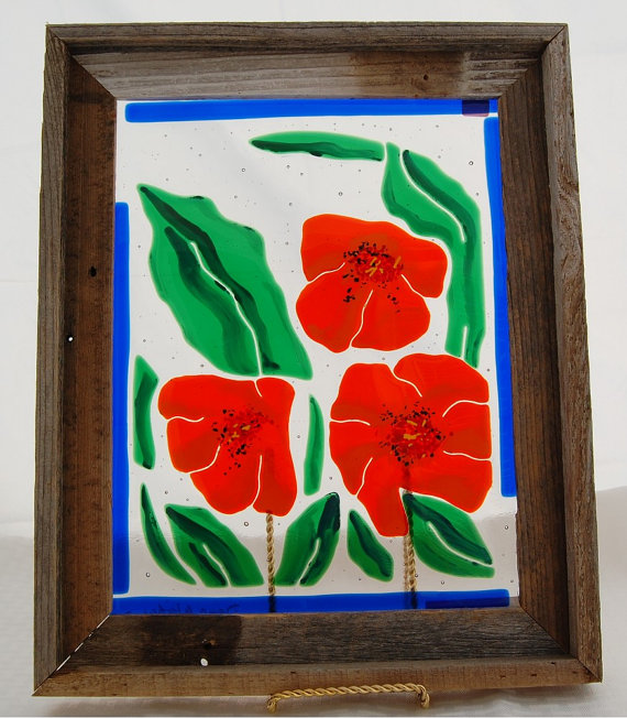

Where the wood is likely to buckled/change shape, I would worry about relying solely on an adhesive.
I think I would seal with silicone around the edges, and then mechanically secure the "panes" in place using wooden strips, nailed to the back. I use wooden strips to secure flat panels into store-bought frames. (for instance, on the attachment). You didn't mention if they need to be viewable from the back... you could still use this method, just making sure you use nice strips with mitered edges to secure.
