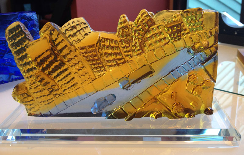

Usually, devit on a surface doesn't bother me much, because I coldwork so extensively anyway. I'm presenting a fresh, clean surface to the heat, so I'm not really giving the devit a chance to grow. When I do get devit, though, it's spectacular. Like this cityscene: Which SHOULD look like this: That one, not even coldwork would save.
