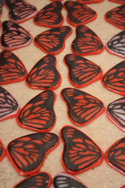

I am currently working on a butterfly wing project.
I silkscreened all the black on the wings after long and laborious attempts at hand painting or applying frit.
anyways, I used Glassline paint, took it up to a full fuse at 1500.
NOW, I want to flip them over and do the other side.
My concern is whether the paint would re-liquefy and pick up kiln wash.
Perhaps this is a dumb question, but I just wanted to check before I do something that might possibly ruin all my hard work.
And I know I could do a sample, but I am kinda working on a tight firing schedule this week and don't really have the time to devote to a firing just for testing.
thanks for your help

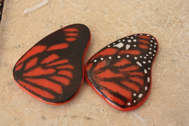

just wanted to report back on the butterfly wings.
I flipped them over, so the face side down was a previously painted (with Glassline) and previously full fused (1500) design of a butterfly wing. I then painted the fae up side, applying the white dots as well and fired it to full fuse (again 1500).
I am happy to report that the previously painted, face down side did NOT pick up any kiln wash. it is of course matte, but that is ok.
thanks for everyones response. I appreciate it, you guys are great!!

yes. that is the temp they suggest. Lower temps leave it matte and kinda streaky looking. 1500 is smooth and glossy. I am not sure if the same would be achieved slightly lower...
