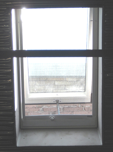

I installed a sky window.
Its like a sky light but it opens up. You open it using a hook on a long stick.
It lets in light (essential for glass art!) and also air.
Its very water tight.
The only drawback is that you have to close it when it's raining...although you can leave it 1 - 2 inches open in a light rain (a bit like leaving your car window a fraction open in a light rain).
