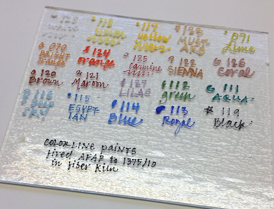

I always fire my kilns with the peep holes open during the entire firing, so haven't noticed any difference with the reds. I haven't worked with Colorline extensively, though.
Here's my test piece:

Re: Airbrushing Problems with Bullseye Color Line
Postby carol carson » Tue Aug 25, 2015 2:50 pm
Yes, I saw you post that some time ago, after they came out. I helped do some testing of them for BE and found the red cracked and burned regardless of how careful I was with it. Thin, thick, it didn't matter. I have to say though, I liked the burned color :) (but that's probably just me) and the red hue when it stayed red.
