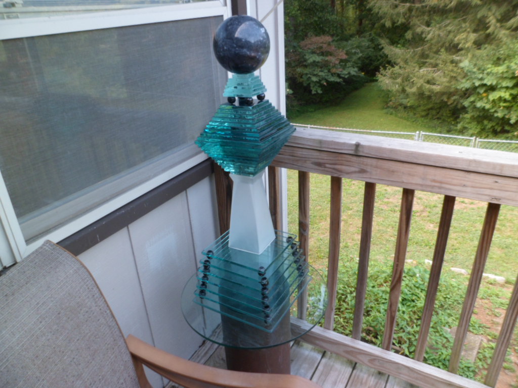

I've used marbles for all types of constructions and have had no problems, do as Morganica instructed and you should not have any problems.[attachment=0]2015-09-06 02.18.16.jpg
large standing sculpture

I was just catching up on posts, and I saw your sculpture Tom...WOW! Fabulous! Is the middle piece that looks frosted cast?
