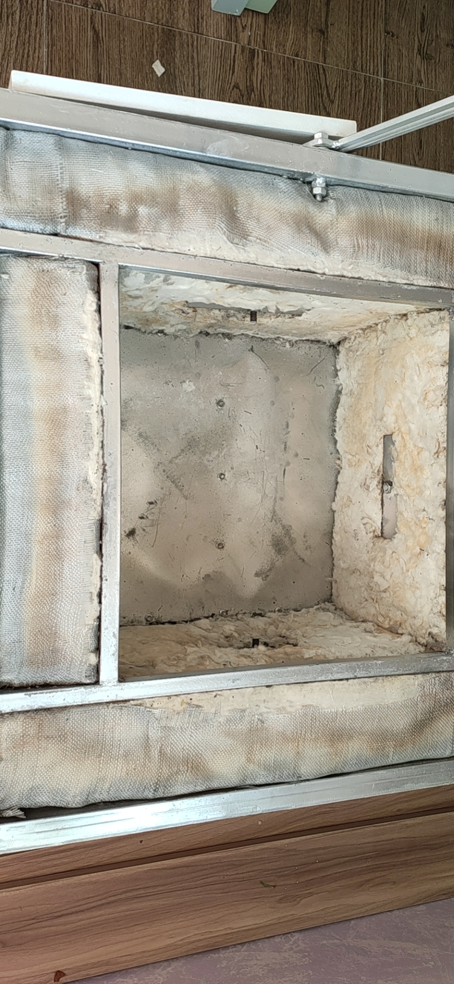

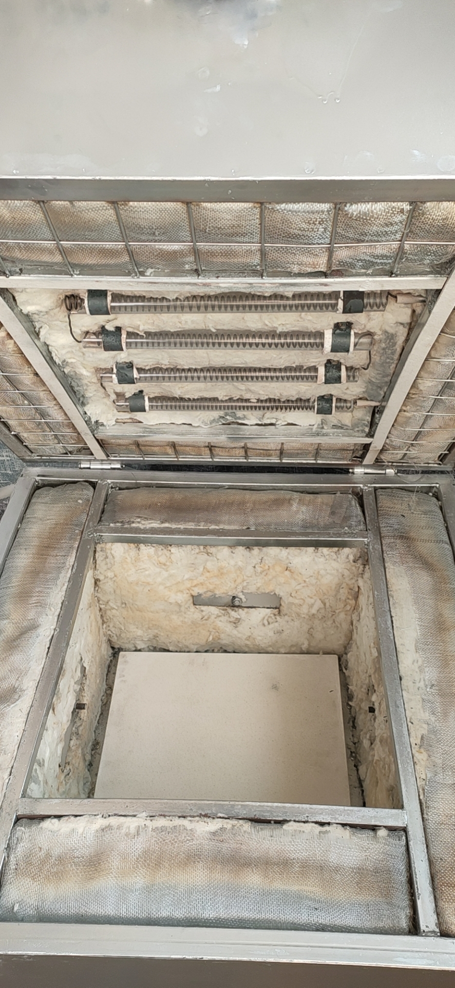

First i must preface that I'm. in China and not easy to. get quality products. I've had to make my own molds, tools and most things from scratch. my kiln I had in USA was small but excellent. I. just ordered a kiln here 18 inches x 18 inches x 12 inch tall internal.
the interior is fiberglass insulation. no heat bricks. there is dust and debris everywhere, i cleaned the metal and oil debris from the insulation. but the floor isn't level when I. put kiln shelf in its uneven. I could try to fix it, the programmer and electrical wiring is attached to the lid. there is no plug so I have to install myself . there is a slight gap. when I put a light in the kiln and closed it, I could see a thin beam.
should I try to make this kiln work? or is it a death trap?
I'm. afraid some debris falls on my glass while heating she ruins it. if the fiberglass falls over time.
is fiberglass safe for kiln work. will I hurt my lungs? I. feel sore throat after opening my kiln first time. I think need face mask every time in open it

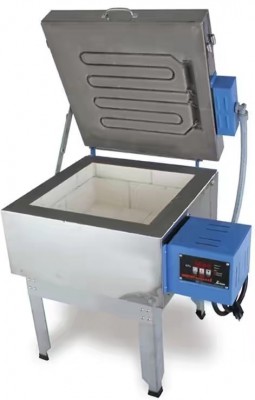

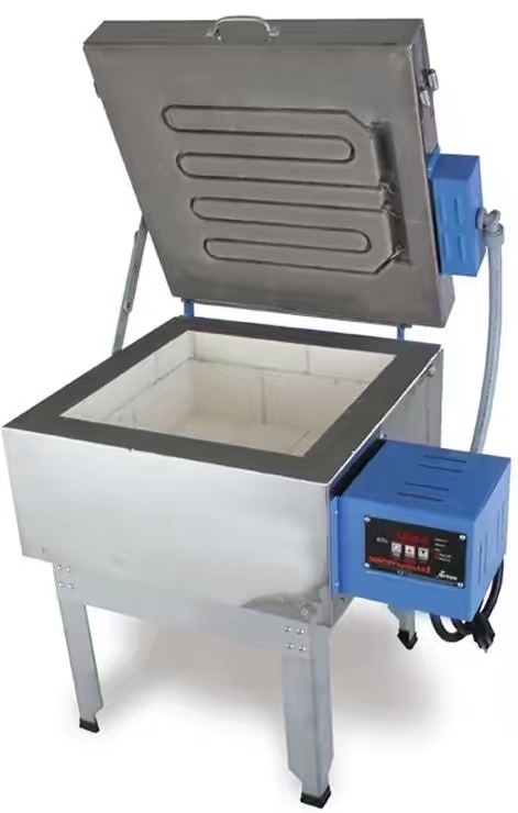

this is what arrived.
this is what I ordered

Not Fiberglass but refractory blanket. Yes you may need a respirator because of the irritation that can occur from handling the material. Generally and take this advice at your own risk, the refractory materials themselves are safe and supposedly non cancerous. Time will tell.
Heating refractory material like this can because it is usually made of Alumina silicate (and we don't know in this case) which when heated can create within the material tiny crystals of crystobalite which is not good inside the body.
The bigger issue is how the kiln was made and I am not about to send my western developed knowledge off to China via this posting.
So it will probably work. In some ways better than the bricks that you desired as they are notoriously inefficient but not half as well as it could have been made. You in theory have a better kiln than one made of brick.
Fired once by you did clouds of stinky sticky smelling fumes come out during the firing?
I can't answer all your questions other than you have a kiln and learn from it.

I'm. not sure if I should send it back. no programmable controller. the interior has rust on the welds and adds debris eveytime open and close, they used spray paint on.the interior to cover the rust.
I'm not sure how much effort I.need to do to fix it or just refund and Try to get another manufacturer. which might not be better

I commiserate with you LOL. What is the metal doing inside the kiln conducting all the precious heat to the exterior?
Good luck.
Whoever made it didn't know what they were doing.
In case you can't get a refund, cutting the interior metal bars out of the lid and bottom may make it usable.
But you did learn didn't you? LOL
