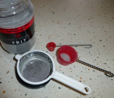

Same question about the little sieves. Is it safe just to wipe them well, or should I wash and dry them each time before using a new color? The sieves are the red ones with a flat bottom and a twisted wire handle.
At present I drop the used spoon in a bowl of water, and use a new one for each color. Wash and dry the sieves each time (currently have only two sieves).
