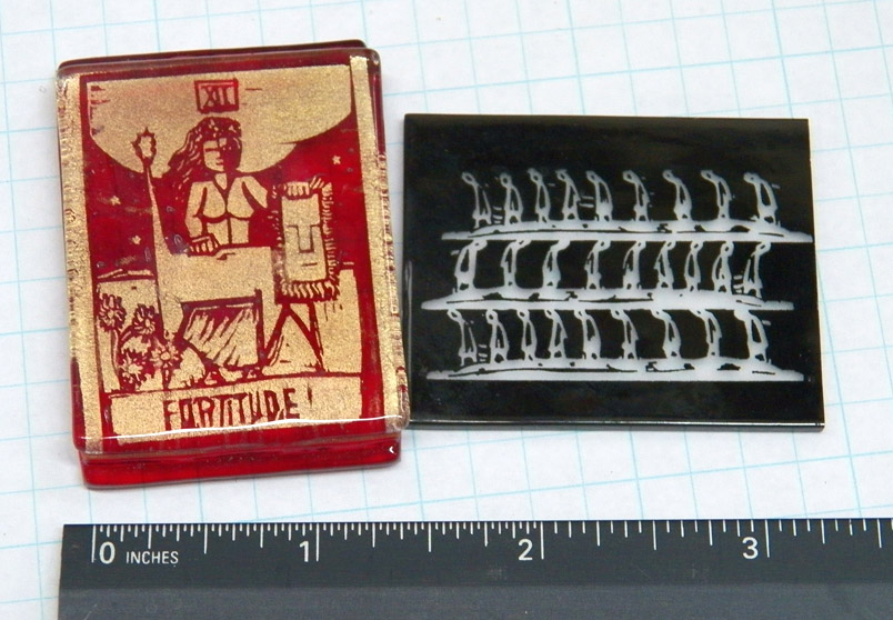

I am quite biased, but here is some work done with Mica (on the left) and black enamel (on the right.)
It is done with a combination of Barry Kaiser's materials, and my sandblasting/etching.
You can't beat the detail, and you colors aren't much of an issue.
I see you are in Eastern PA, I am in NW NJ...
Guy

Thanks Guy, yes, we're north of Philly, looks like you're near where our son goes to school. And yes, your work is super.
