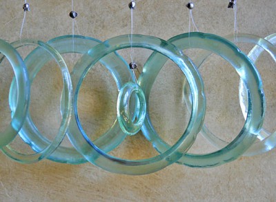

I have a question about a small glass design I want to make as part of a larger recycle project. I am sure everyone has seen the wind chimes (just an example) with rings made from wine bottle slices. But those slices are usually very irregularly shaped and the sides are flat, I believe from being slumped on a kiln shelf.
However, I have seen a few of these rings that have maintained their circular shape and are not quite as flat on the sides (see large rings in attached image). Is this the result of less time in the kiln or an artist who is very experienced with slumping?
I thank all for any input offered.
Paula

less kiln time and the rings were nice and thin to start with. if you are going to be cutting glass on a tile saw do not forget to wear a dust mask or respirator. last time i forgot to do that my chest felt like i had pneumonia for a week. rosanna

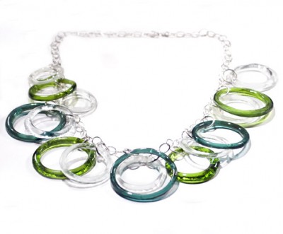

I found great image that is an example of what I am talking about (see the necklace). How are they getting both sides of the ring round?
Thanks again
Paula S
Thanks again
Paula S

Have you asked the artist?paulas wrote: I found great image that is an example of what I am talking about (see the necklace). How are they getting both sides of the ring round?

I've thought about that too. You could try a plaster mold. That would offer round edges on all sides, but the mold side would be rough.
It's good to copy others' work to begin learning about glass, but it's better to create own, unique, styles and methods when you begin selling to customers.

Lots and lots of ways to get there. The easiest would be to simply lampwork the rings out of rod, with a bench torch. Or you could form them from scratch in a hotshop with a punty, or cut your bottle rings and then firepolish them in the gloryhole (doing fast work to keep them round). Or you could slump into a mold, as Judd suggests. Or cast them with a ceramic or plaster/silica mold.
If they have the same glossy surface on all sides, they're most likely hot-formed. If one side has a less-shiny/more-textured finish, they're more likely kilnformed. You could also kilnform them and then coldwork the result back to an even, glossy finish all over...but that means a heck of a lot more work and/or additional equipment.
In other words, if you want the same glossy finish on all surfaces, there's gonna be a learning curve.

i think that they juse LOOK round. those look kiln worked to me. i would guess really thin rings fused hot on really smooth kiln wash. rosanna

I would argue "not necessarily". If the bottom of the mold were concave then that side would not be flat and the top side would still round out some.paulas wrote:
As Judd mentioned, if a mold was used, or even slumping on a kiln shelf, one side would be flat. I was struggling with figuring out (with my very limited knowledge) how that might work.
Paula
Of course, that would likely be an expensive mold for inexpensive bottle glass.

Hmmm ... still a puzzle to me. First of all, those rings in the first image do not look perfectly circular to me. Nor is their circular cross-section a consistent size. In addition, the diameters of the rings vary significantly - do you think they were cut from bottles? Also, it's hard to tell what the "back" looks like - is it smooth/glossy? Textured?paulas wrote:
... However, I have seen a few of these rings that have maintained their circular shape and are not quite as flat on the sides (see large rings in attached image). Is this the result of less time in the kiln or an artist who is very experienced with slumping? ...
Paula
In the first image, the rings look "notched" at various points around their circumfrences - from whence sprangeth those, do you suppose?
And finally, Paula, you mention "slumping" the rings. I'm thinking you're talking about fire-polishing them after they've been cut from a bottle - is that correct?
I, too, would like to know how to make perfectly circular rings with consistent circular cross-sections and a gloss finish, but the process sounds too daunting to me. Good luck - hope you figure it out.

Those could be cut from wine bottles. I wonder if one of those flower making molds would work. The kind with the hump in the center, assuming the ring would fit around the hump. I bought a round bead mold to melt bottle necks into but the manufacturer says not to use bottle glass in it. I'm not sure why.Judd wrote:I've thought about that too. You could try a plaster mold. That would offer round edges on all sides, but the mold side would be rough.
Re: Slumping technique question
Yes, I'd guess the glass was wine bottle, and cut into rings on a saw, but I wouldn't buy a mold. Just make one out of plaster. Find some plastic, donut shaped thing and make a plaster mold out of it. KISS = Keep It Short and Simple.

Just FYI, I do not know if the image in my second post, the necklace, was from bottle glass.
