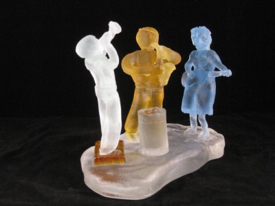

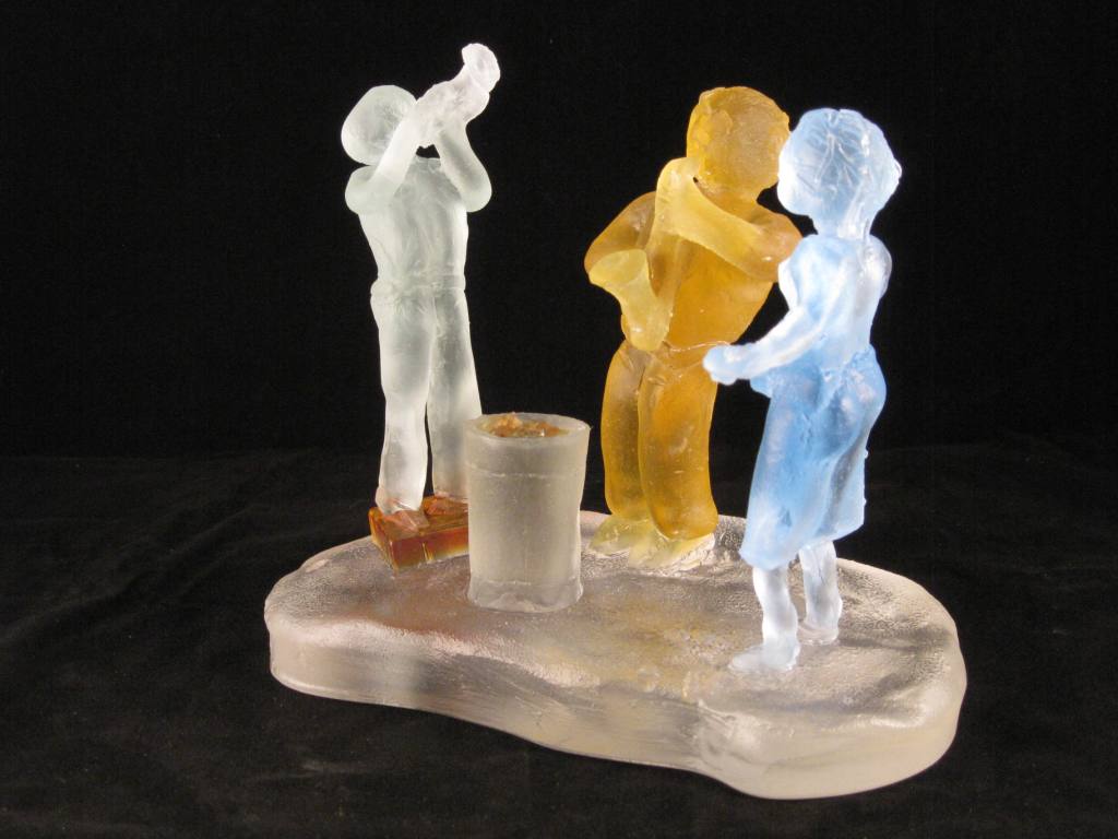

I've been playing around a bit with getting some multi-colored castings. This was the first practice model.
Tim Yardic

Looks great. Are you casting them together (or recasting with inclusions), or casting the pieces separately and gluing them in?
Yardic Glassworks
Posts: 80
Re: Almost There
Post by Yardic Glassworks »
Each of the characters, the barrel and the box are cast individually, then placed onto a wax base, reinvested, wax out, clear glass in.... so the piece is one solid piece, no glue. Tim
