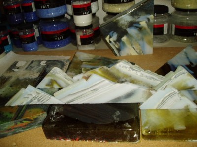

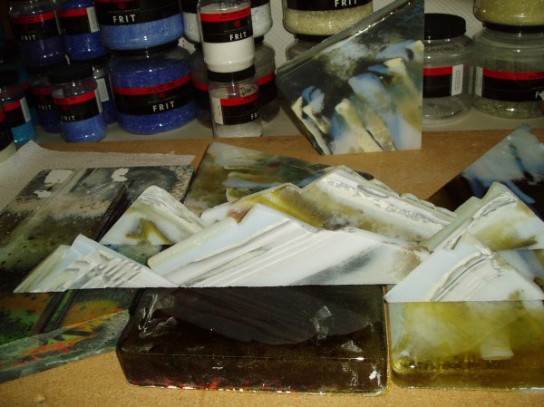

Since the winter is apon us I am inspired to create some new snow mountain scenes. Here are the slices that will be incorporated into the glass panels

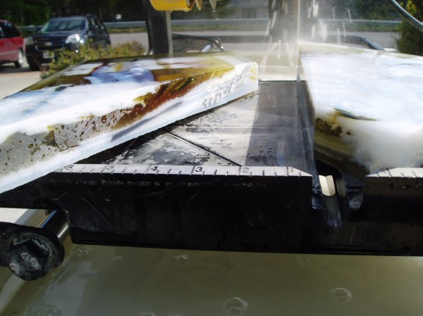

O.K. now I am happy, we just changed the belt on my saw as it was taking so very long through a cut AND WOW!!!!!!!!!!!!!!!!!!!! I am saving hours. I also have 4 new blades coming that I am testing and will keep you all informed on which is my favorite.

I am needing to order a new saw blade. I've always used Result blades, but I'm wondering if there might be something better available. I sometimes cut thick slabs (1-1.5") and I'm wondering which blade is your preference?
Colleen/azgram
Re: "WINTERS COMING"
I wish I could have a 14 inch blade to saw my bars BUT such is life right now, a 10 inch blade will have to do. I took Mary Kay's suggestion from Bullseye and tried some MK Diamond Blades . I am really really pleased with the 10 inch MK-333JB Hard Tile J Rim. Still my most excellent blade is DeWalt XP Extended Performance 450X Longer Life blade . Even though I have to use 10 inch blades for now, I am able to cut over 3 inch blocks , (if you want to go 14 inchs long you have to turn the glass around near the end of the cut as it hits the back section of the saw, BUT it makes it through underneath the bolt.
For fine no chipping , and for 1 inchs I use the blades from His Glass works. He can suggest which one will work best for you with out chipping but it is just abit slower. The continuous rim blades don't have the J slit in them for chomping through the glass and it takes alot longer to cut if it does not have the J slit BUT you will not chip as much. Slow way down at the end of the cut and you should not chip the end. The blades I am using and suggest are definately for thicker work .

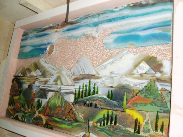

:D A lot of times it is the colour bar design that you have to think of first that will dictate the lay out of the design. I know what I want to get when choosing the colour palette . My dad was an architect and perhaps I think upside down and inside out like he did. I was a seamstress long time passing , designing my own leather jacket patterns and cut and punched all the holes and wove it with the leather strips I cut so perhaps I have always thought 3 dimensional. Thanks for the thoughts.
I think I made a slight error on this one though in one tiny area in the centre. It will not show on the front BUT I might have to put it back in to change the back side. But hopefully it did not ruin the look of the back side. I grabbed Teal opal instead of teal frit. So we shall have to waite a few days to find out if my messy studio has ciboshed me!!!!!! :-k

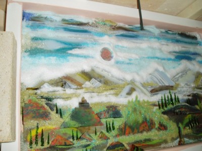

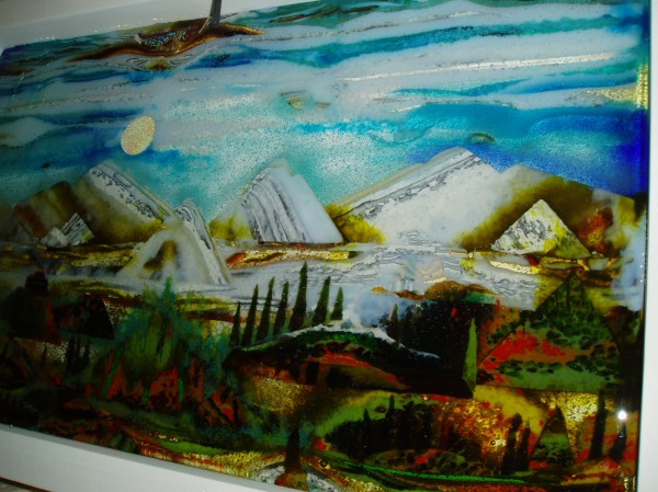

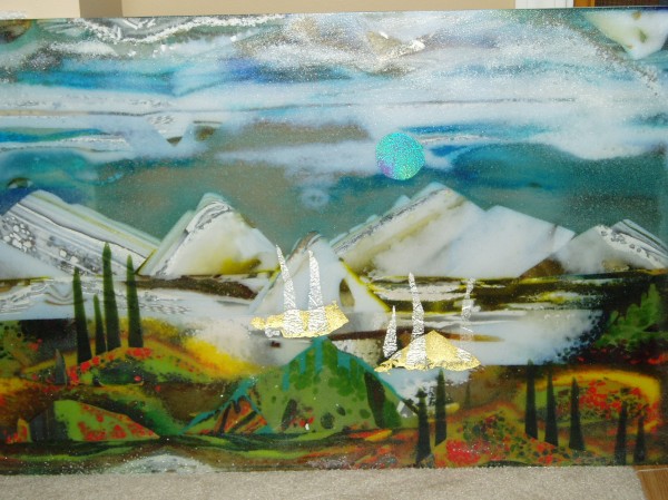

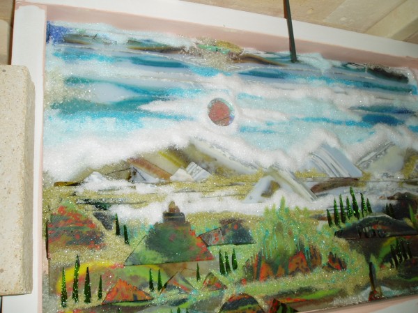

Here is the front side. I think the slight mistake is going to bother me for some time now. I might have to re-fire, but I will pull out and check the back side first to make a decision. BUT the mountains and sky are what I was hoping.
Post by Yardic Glassworks »
Beautiful piece. Pretty sure you will be the only one who sees the "mistake". T.
Tim Yardic

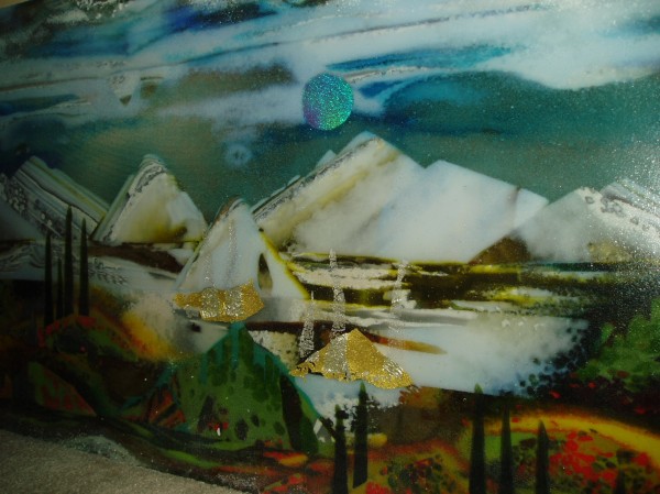

Yardic Glassworks

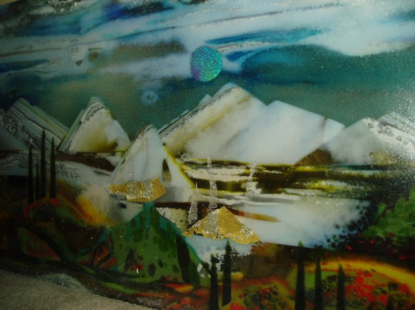

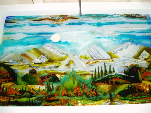

Thankyou T . Here is the back side. I am actually O.K. with the back . I have not cleaned it yet but the mistake I was worried about is in the center section and the back survived by placing the gold and silver foil in certain places. :)

What is the finished thickness?
Tim Yardic
Yardic Glassworks
Only 7/8" inchs. 27" long x 17 inch tall x 7/8" inch thick Les
