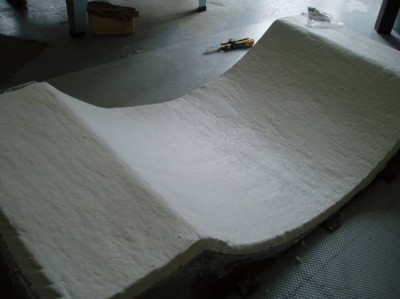

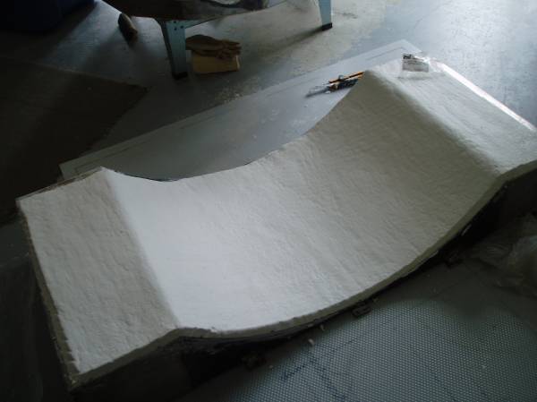

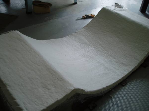

I am excited to experiment with Zircar Refractory Composites Moldable material ( Refractory Textile : RS-A Moldable ) while at Uroboros Glass Company . This is covering my large 44" inch stainless Steel metal Mold. My glass panel will only be 39 inchs long by 17 inchs wide but will be a fun experiment to help the glass slump and not to worry about sticking and shrinkage.

How thick is the glass piece???
Lots o' Luck and success in slumping / forming!
What schedule will you use??
Re: Mistakes and Taking Risks
Postby twin vision glass » Thu Jun 26, 2014 11:59 am
The glass will only be 3/4 of an inch thick. ( and only 40 inchs long) The schedule will be slow . 50 degrees per hour up to 1200 F. It will probably be nicely slumped at 1160 F. but because the Euclid Kiln is so large, I cannot open the lid to watch. I will drill some holes in the Ceramic Fiber coating I have laid over the metal so I get no surprises. :-k [-o< It is all just experimenting in a different kiln that I am used to and the Euclid kiln is top and bottom fire so hopefully no surprises [-o< [-o<

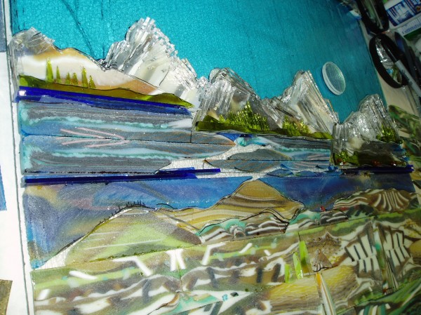

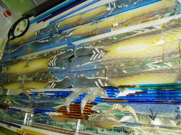

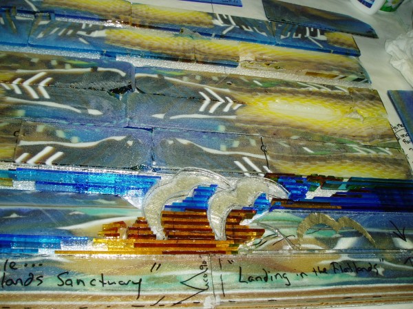

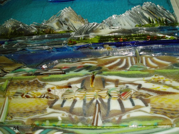

One of 5 panels to be created at Uroboros Glass Company Residency in July! More layers of clear to go on this but transporting layers of cut pieces and the finished cut panel is a trick in itself. Had to get a PaPs Manifest done tooo so going over the border will be alittle easier this time I hope. I just wish it was not so hard to get into the USA but hey! my motto is do not sweat the small stuff. So off I go to finish the other panels before I arrive there as time will be short to fire and then slump this piece called: "WETLANDS SANCTUARY" . Look so forward to seeing a few of you while in Portland too! Leslie

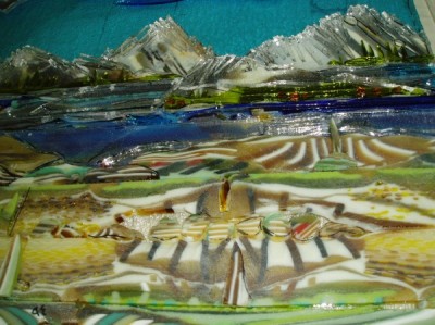

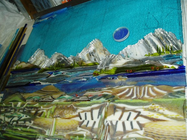

Thanks for the encouragement. I am working on the next 2 panels to come down with me to the Residency. Fun for sure . Here is the beginning of number #2
Way tooooo much cream colour so I have to do a lot more work but will take it with me ( carefully wrapped of course so nothing moves around so hopefully NO pot holes in the highway for my 15 hours drive
Posts: 580
Postby Havi » Mon Jul 07, 2014 3:40 pm
1. Beautiful! Really like it
2. IMHO, NOT too much cream. I would have left it as is - - - - -
3. Good luck!
Postby twin vision glass » Mon Jul 07, 2014 5:25 pm
Hi Havi,
Well sometimes I get worried about cream or white in the middle of pieces reflecting heat away as dark colours absorb more heat and light ones keep abit cooler sometimes Sooooo! I had already changed the piece ( and am actually a lot happier with composition now :-k ) so let me know what you think :-k [-(

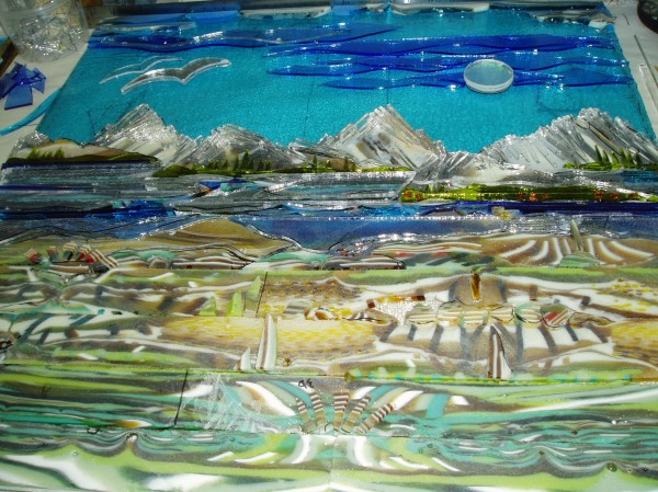

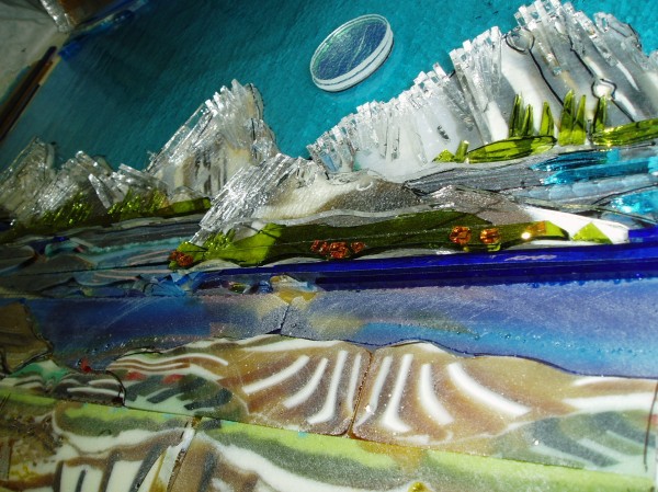

Postby twin vision glass » Mon Jul 07, 2014 5:29 pm
Here is the section that \I changed and am much happier
