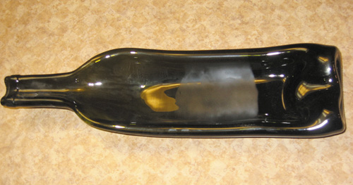

Here's a photo I found doing a Google search for divitrification:

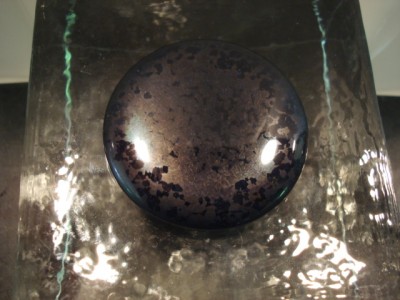

Here is a picture of what I have been trying to describe. The clear glass around the blue is only a background I used for the photo and is not part of the piece. So is this Devit or something else?

Re: Borax spray on plaster molds

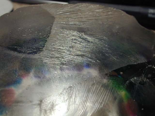

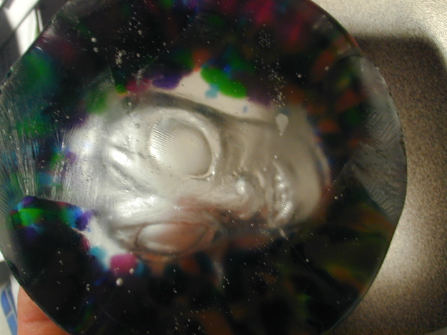

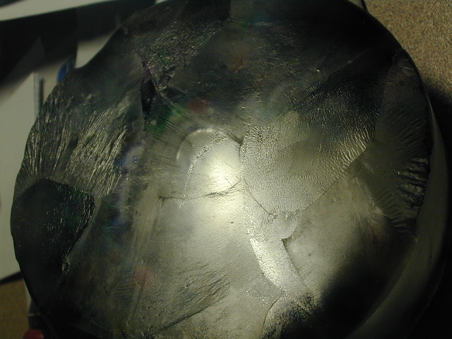

Here are some views of devitrification (same piece). What you are seeing is actual crystals beginning to grow. I suppose under the right temperature conditions, and enough time, you would start seeing actual crystals. You can see in the photos some large patches which are the molecules starting to line up and select growth planes. If you had a plate full of bb's you would see patchy patterns as they bb's find resting places. Hope this helps.
Nice shots. And yup; I've had them go all the way to crystals. Looks like whiskery rock candy--had that happen with pate de verre in a plaster/silica mold once and I was surprised at how large (maybe 3-4 mm) the crystals can actually become.
