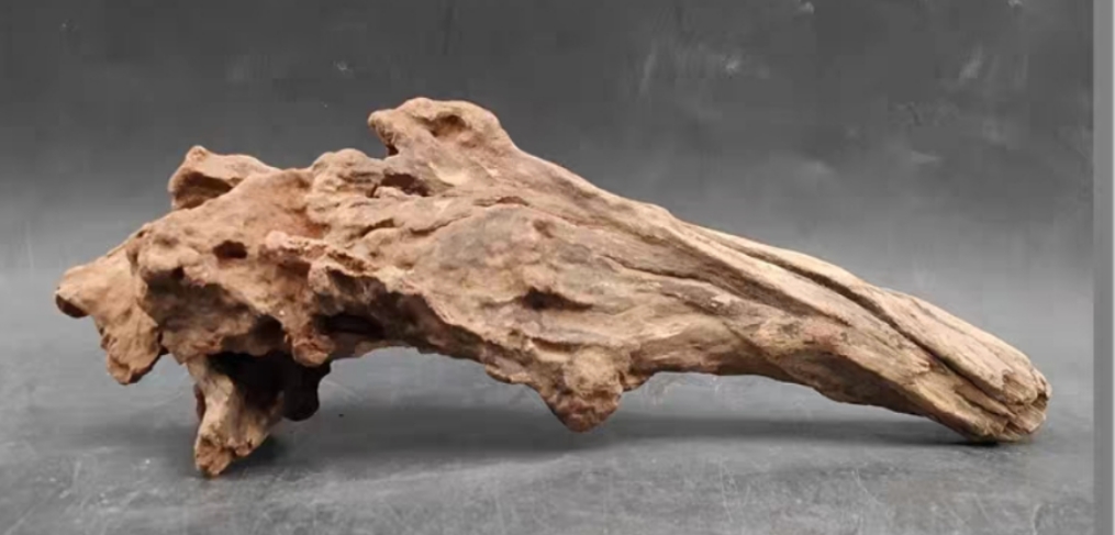

I have this piece of driftwood id like to try and cast in glass. it has some undercuts, I was going to make a silicon mold, then cast in wax, then make plaster/ silica mold.
is there any suggestions or tips to accomplish this. I wasn't sure if I need to make 2 part mold or if softer silicon could just pull off.

There are definitely ways to do it. I learned with a great teacher named Judy Hill at Pilchuck. It's a little complex especially trying to show in pictures. It involves multi coats of silicone and then making a line with a release and another coat after that. Then being able to cut through. Kind of like having a flap. You also have to consider where your pour will be. You could also consider multi part molds. Might be time for a mold class.

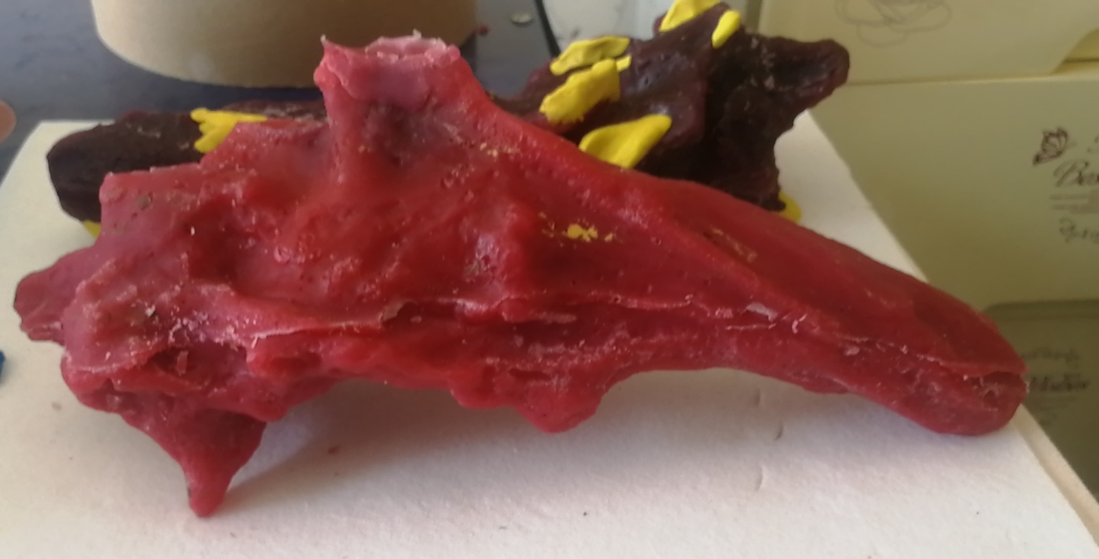

as a follow up, I made the silicon mold, I filled in some of the deep undercuts. then I made wax casting. added the deep cuts and fine details. will pour plaster silica mix tonight. thanks for all the tips.
