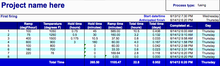

Hi Bert,  Not sure when it happened, I know before I went to bed I looked at the controller and it seemed on schedule, then I checked the kiln this morning at 11:30 a.m. and it was just starting to anneal, which surprised me.  I started the program at 7:30 p.m. the night before.   The total run time was 22 hours 03 minutes.
My schedule was
100 1050 45
75 1250 30
400 1500 10
9999 900 3.0
100 800 0
180 700 off
Not sure if I needed the bubble squeeze but the powder was thick in some areas.
I was slumping a 9mm, sys 96 blank, onto a bas relief carved in 3 layers of fibre paper coated with layers of powder. which is why I went to 1500 to fuse the blank to the powder. I was using top and side elements. The top element is 6 years old, sags in a couple of spots even though I've used epoxy to keep it in the channels. I know I need to eventually replace the element but I've been reluctant.

Mary Lou wrote:Hi Bert, Not sure when it happened, I know before I went to bed I looked at the controller and it seemed on schedule, then I checked the kiln this morning at 11:30 a.m. and it was just starting to anneal, which surprised me. I started the program at 7:30 p.m. the night before. The total run time was 22 hours 03 minutes.
My schedule was
100 1050 45 =ca 11'15"
75 1250 30 =ca 3' 10"
400 1500 10 = ca 45"
total of ca 15 hours 10. 19:30 plus 15:10 hours =10:40 am so I don't think you have a big problem.

Stephen, The kiln was at 78 when I started and I think it took 2.5 hours to finish the bubble squeeze, so that adds a variance of about 2 hours to what I calculated. Should I not be concerned?

Are you sure you're not miscalculating? I ran your schedule through my spreadsheet tool and came up pretty close to Stephen's schedule. (Mine's a bit shorter, I think because I was starting from 78F):
I have you reaching the 900F anneal point around 11AM, give or take some time, which isn't too far off from what you observed. It sounds as if your other firings go much faster--are you sure they're the same schedule as the slowpoke? Obviously I don't know what kiln you're using or how fast it spills heat--in one of my kilns this schedule would run maybe 8 hours longer because it's very, very good at holding in heat.

Cynthia, thanks for the spreadsheet check, what a neat idea.  My other firings do seem to go faster, but there are variances in the setup and design. I need to do more monitoring and comparing of schedules to like work and making better use of inf. in my notes.  My kiln is an Evenheat 23".  I Stephen I apologize for thinking my calculations were more in line.  Susan, I hope it's not the relay, but I do have spare relays and a new element on hand.
One thing I didn't mention and may have caused the difference is the work is well dammed with kiln furniture and firebrick, it's 11 x 17 and 10mm thick. I don't think I will tinker with anything before everything is finished, Thanks all for the feedback.

No prob. I set up the spreadsheet several years ago, mostly for casting so I didn't have to keep getting up in the middle of the night to close the vents. The spreadsheet lets me play around with the schedule so that I can pay attention to the kiln at reasonable hours.

That's something I'm just starting to work on. It's nice not having to get up in the middle of the night to monitor the progress of unusual runs. Thanks again. The project in discussion turned out fine.Morganica wrote:No prob. I set up the spreadsheet several years ago, mostly for casting so I didn't have to keep getting up in the middle of the night to close the vents. The spreadsheet lets me play around with the schedule so that I can pay attention to the kiln at reasonable hours.

I posted it on my blog a few years back. It's probably gone through a bunch of revisions since then but most people customize it for their own use anyway...DonnaG wrote:Nice spreadsheet. Is it sharable or for sale?![]()
I'm finding that some of my schedules seem to be taking an awfully long time. A friend has the same size kiln (I know --no two kilns are the same but still.....i have the Olympic GF314ETLC) and the same firing schedule takes her 19 hours and takes me 23. I tried Spectrum's slumping schedule and it was a whooping 35 hours before the temp was back down under 100 degrees.
http://www.morganica.com/bloggery/2008/ ... ring-time/
