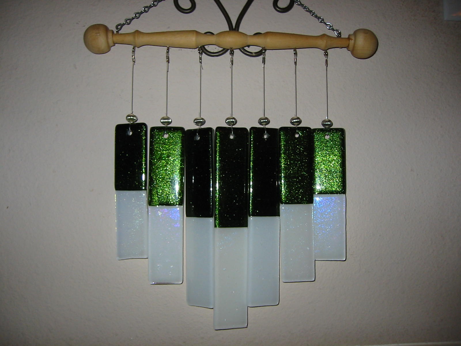

Hi all,,I am uploading of my chimes I made for a client...very normal not very artistic but pretty none the less and they sound great..dont know whether I will continue to drill or not..thanks for looking
