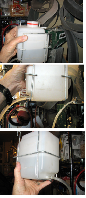

I purchased a used Wet Belt Sander a couple of years ago, and it came with an ingenious drip container - it is simply a stock windshield washer container from auto supply - tubing was added at the bottom to direct the water to my Sander. There is a control valve on the top of my Sander, but I'm sure this kind of control is easy to obtain and could be connected somewhere in the water line itself . . . that might be better, since I have to remember to lower the container before disconnecting unless I want to get wet. The hanger was modified to hang from metal shelf near my Sander.
I am going to try to upload a picture so you can see the container.
