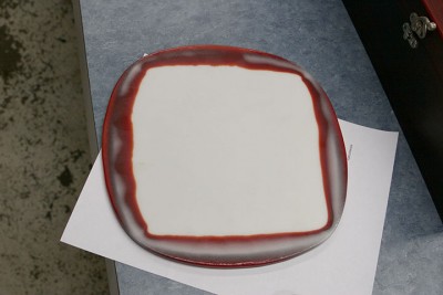

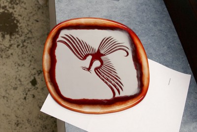

You are right on the money. The insides squish out / move much faster and further than the top and bottom.
Here are a couple of photo that show it. 4 - 1/8" layers between two shelves.
Guy

GuyKass wrote:Haydo-
Guy
Very cool, Guy. Is the "bird" screen printed?

Re: compressing glass
Post by GuyKass »
Thanks. One of the zillions of things I start and never finish around here.
Actually it's etched/sandblasted/carved, whatever one would prefer to call it.
I vary the thickness of glass by varying the layers, etch through them and then (usually) fuse back onto clear to the desired thickness.
I'm dying to roll them up and make vessels. Just never enough time or money.
Sort of a poor man's Graal.
