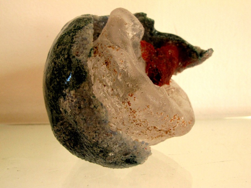

Postby orittlandau » Sat Mar 15, 2014 2:15 am
i try to combine casting and pate de verre and got a little crazy reasults 8)

I made several tests: here is one of them. The white is a cast piece that which I surrounded with green red parts of pate de verre.
i am in the beginning ot testing this combination.
oritt
