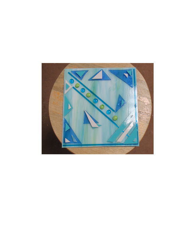

I am a potter bitten by the hot glass bug! I am just beginning to experiment with the glass kiln option on my Paragon Janus-27 kiln.
It is 20" deep so I know I will have to raise the shelf up pretty high. What would be the optimal distance between the glass piece and the elements in the lid?
Second question: Here is the fusing schedule recommended on another site for fusing 3 layers of COE96:
1) 300 to 900 soak 15 min
2) 500 to 1100 soak 00 min
3) 100 to 1250 soak 30 min
4) 9999 to 1475 soak 10 min
5) 9999 to 950 soak 60 min
6) 50 to 800 soak 00 min
7) 100 to 700 soak 00 min
8- 300 to 100 soak 00min
I've attached a picture sample of what I'm calling three layers. Stacks of three in places, but not covering the entire surface.
Third question: is there a problem with attaching pieces with Elmer's glue to stabilize the pieces? Does the glue leave any kind of residue behind?
I would really appreciate any help anyone is willing to give me. I have been going though the forum archives and have seen how helpful the members are.

Re: Fusing Three Layers
The shelf should be below the temperature sensor. The side elements should be baffled so radiant heat does not directly affect the edges of the piece (avoiding the risk of sealing the edges too early)
For this kind of lay up I would use something like (all in Celsius)
200-625, 10mins
50-675,30 mins
300-800,10 mins
Afap-482,60 mins
60-428,0
120-370,0
240-100,0
Off
Yes, the glue can leave a residue, so use a little as possible and only at the edges or ends.
Liz, you may wind up with some volume control issues with that layup. There's an old maxim in fusing circles: Glass "wants" to be 1/4 inch (i.e., two layers). Given enough heatwork, glass that's less than 1/4 inch will draw up to become 1/4, and glass that's more will spread out.
Where you have 3 layers, especially near the edges, the fully fused glass will have spread out, while the 2-layer areas will pretty much keep their volume. If you have straight lines at the edge, they could wind up a bit more crooked than you expect.
If you're not worried about the edge, it's no problem. If you were planning on straight edges, there are a few solutions:
1) Don't flat-fuse--apply less heatwork so that the volume stays vertical instead of spreading.
2) Plan on trimming the edges straight. You've got straight lines near the edge, so this method chop off something you don't want to lose.
3) Add an inch or so on each side of your base glass, so that a 10x10 piece becomes 12 x 12, and flat-fuse as normal. The volume change will (mostly) be absorbed by the extra glass, so that you can simply trim it back to the right size and slump into your mold.
If you're concerned about keeping your lines absolutely straight, you can also fuse this pattern upside down, so that the decoration is on the bottom, facing the kilnshelf. The kilnshelf is the most insulated part of the fuse, and you've also got the weight of all the glass pressing down on the design, so the lines stay (much) straighter. Do a search on this board for "flip and fuse" or "flip n fuse" and you'll find a lot of information on it.
I will reign myself in and start out with a simple two layer design. I must learn to crawl before I run, lol.
