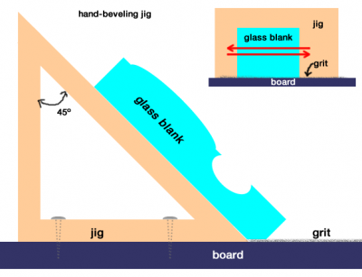

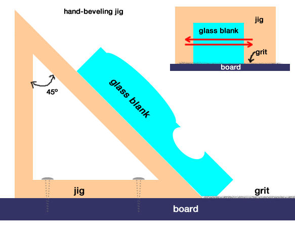

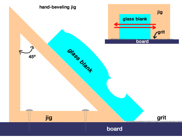

I set up a jig that lets me use loose grit or sandpaper-on-board to bevel edges and it worked pretty well. You make a right triangle out of three boards, attach it to the table next to your grinding surface, and move the piece on the angled board, grinding down the corner. You keep doing that until you've gotten as much bevel as you want (it's also a good way to just put a 45-degree angle on an edge when you're joining pieces). Like this:
If you mess with the angles you can pretty much put whatever degree of bevel you want on the piece. My friend Bob Heath rigged an adjustable jig for his tile saw this way--he does very precise joinings (if you haven't seen his work, you should--it's gorgeous).
And if you flip the jig over you get a 90-degree angled jig that makes it very easy to get perfectly perpendicular grinds.
Mine works for anything with a large flat plane and a straight edge, where you can rest the glass flat and push it back and forth. The downside is trying to do something curved and/or with no flat back to rest on the jig. You could do a vase, for example, but it might drive you crazy trying to hold it straight while you ground, and keeping it rotating evenly.
