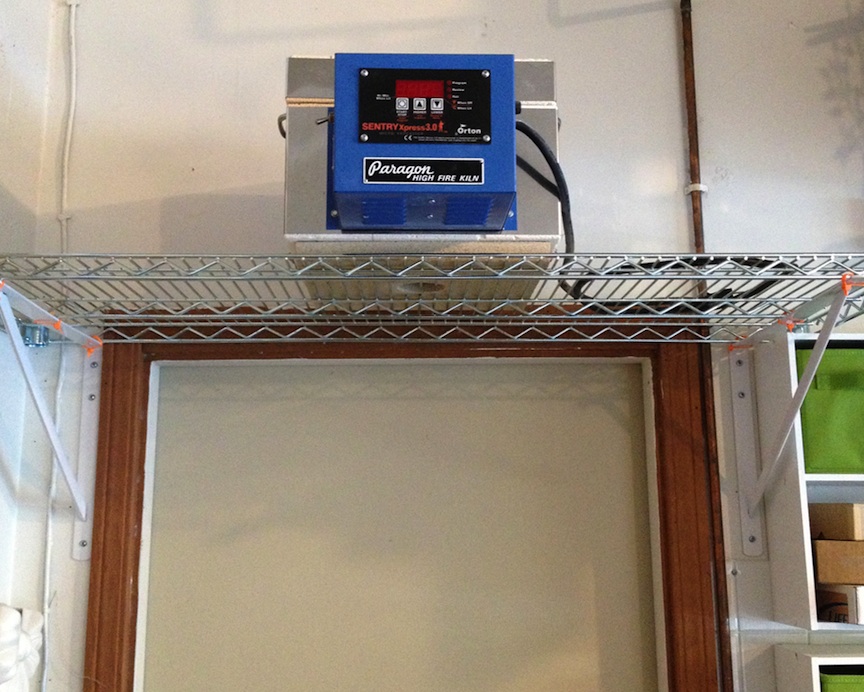

If you decide to go the vitrigraph route, here's how I've got one of my kilns up and out of the way. This is one of my studio doors, so there are studs on each side of the door frame. Simple metal shelf from a restaurant supply company. I cut a few of the bars with my Dremel tool to allow me to pull cane.
