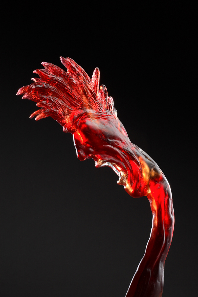

Same problem in casting--most reds opacify with prolonged/high heat, and some go livery. If you buy a glass especially meant for casting, you'll have better luck. Bullseye sells Burnt Scarlet Striker and Ruby Red Striker. The first is a hotter red, the second more of a blue-red. The billet and frit will stay transparent red when you cast with them. This Burnt Scarlet piece had two separate firings with a 4-hour process temp in the 1525F range. It kept most of its transparency, although it was less transparent after the second firing:
I'd get some and test it, see if it works at high temps. I would think that the sheet glass would work, too...but I would test first to make sure (or call Bullseye).
