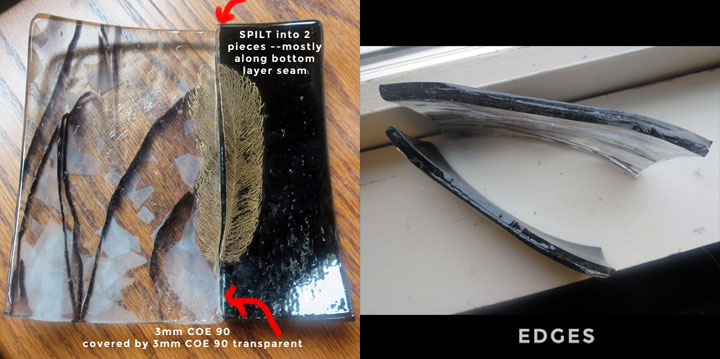

The fusing firing looked ok. During he slump firing the dish split apart pretty much along the seam of the top glass. I used two 3mm layers of COE 90 glass.
The slump firing schedule was:
250 to 350 soak for 12 min
350 to 750 soak for 22 min
FULL to 1400 soak for 15 min
FULL to 900 soak for 1 hr.
100 to 70 soak 1 min.

What do you mean by "seam" of the top glass - was it two pieces that you fused together? Also: In the picture, it looks like the bottom was of two colors - is that correct? Or is the black-looking right hand side just an artifact of the camera shot?

Yes, it is 4 pieces of glass: two on top, two on the bottom and the seam for both layers was in the same place. Was that stupid maybe?

I would think that the markedly different colors would require an especially slow schedule, since the two colors absorb heat at significantly different rates. That would cause undue stress to occur at the joint line.

conboc wrote:Yes, it is 4 pieces of glass: two on top, two on the bottom and the seam for both layers was in the same place. Was that stupid maybe?
I wouldn't go so far as to use the word stupid, but there's no need for the top layer to be two pieces, especially since you're placing a decal on top. The top layer could've just been a single piece of clear which would also help to hold the two bottom pieces together, assuming a successful first firing.

I've made two more dishes and used a solid piece of clear for the top, and yes, that is working fine. I am realizing that design choices need to be tempered with practicality, at least for a beginner.
