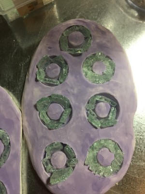

Hi all!
I am new to glasswork(lampwork, fusing glass).
I try to use the bottle glass to make beads.
From the lampworking, I got nice beads with using bottle glass, but I am still struggling with bottle frit casting.
I made frits from bottle glass and tested them on the molds with the several firing schedules, but all failed. I am frustrated from lots of tests and errors at this point. (I use the mold that I made with low fire ceramic.)
I really need help from you, experts!
1. Which firing schedule is good for recycled bottle glass frit casting?
The below is one of the firing schedules that I used and it didn't really work.
also fired on 1600 no hold, but it really didn't work and now I have no idea what the issue is...
Seg 1. 250 per h, 1550, 20-30mins
Seg 2. 80 per h, 1090, 30 mins
Seg3, 80 per h, 400, 0 and let it cool.
2. Is there any firing schedule that you are using for the bead batch annealing? anyone use the batch annealing?
I use the below firing schedule during lampworking, but I think the batch annealing is better for energy saving and easy to work.
Seg1. Full/ 1050(for bottle glass)/ 2-3 hours(depending on work hour)
Seg2. 100/ 750/0 off
Hopefully, I can get the answers
Thank you!

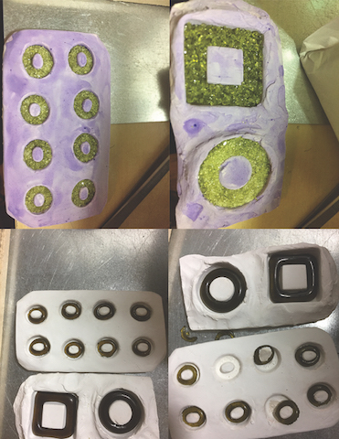

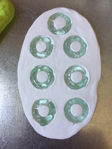

- Posts: 7
- Joined: Fri Oct 20, 2017 9:59 pm
Re: bottle glass frit - firing schedule
Hi Judd,Judd wrote:Are you wanting to make something like the African Bottle Beads? If so, you should crush your glass until its powder. If you're expecting your frit to smooth out like fusing glass, that will never happen unless you hit really high temps - like 2000 Fahrenheit.
At least, that has been my experience. I found bottle glass castable at Cone 05, but I saw a lot of devitrification.
Thank you for your help! So the fruit size is really important. Right? Should it be less than 0.1cm I guess?
Cone 05 is 1888 F. Right? I tested with 1650F and hold for 10mins with medium frit size. It melted better, but it is stuck in the molds(I had to break the molds...) and I got needle points around the glass. ===> please see the attached.
Do you think I should lamp up more or less?
or maybe I should hold them for less time?
I am not sure! hmmm...
If this is art glass and got needlepoint and is stuck in the mold, what would you do generally?
Hope I can get an answer! I am still searching and testing. I will also upload more result.
- Posts: 478
- Location: Hillsboro Oregon
For fusing compatible art frit, make sure that your mold is prepped.
I use ZYP coating from colour de verre. You can also use BE kiln wash.
Then after you put in the frit, either/and/or, mound it in the center of the mold with the sides a little way FROM the mold.
This will allow the frit to CLIMB up the sides of the mold instead OF sliding, WHICH CUSES THE NEEDLE(WIDIWMAKER :>) POINTS.
The other Jim
The other Jim

Hi Jim,jim simmons wrote:For fusing compatible art frit, make sure that your mold is prepped.
The other Jim
Thank you for your advice!
I've been using kiln wash or ZYP as well, but I am not sure why the glass is stuck in the mold.
maybe the coating was not enough...?
so you recommend that the frits should look like the mound like domed frits? right?
I will put the frits like that.
Which size of the firt would you recommend for the small bead castings?
I saw your work from your website! They look really awesome!
Thank you
