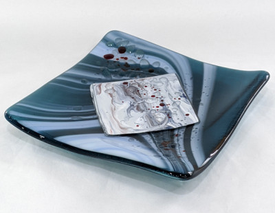

I know with the Colorline enamels, the reds will burn out unless they are fired on their own. They are affected by a reduced oxygen environment so any organics in the kiln that are burning off will affect the color (including the binder in other enamels in the same firing) So, paint with the red first and fire. The kiln needs to be vented until about 1000 deg F / 540 deg C to increase oxygen. Once the reds are "set" in the first firing, they should be OK to fire with other colors. I usually avoid using them because I am lazy :)
With this piece below, there was a LOT more red in it, but all that remained were a few red/rusty streaks after firing (the red dots are frit). You thought all my work was perfect (ha ha) :mrgreen: I just try to make the best of it.
