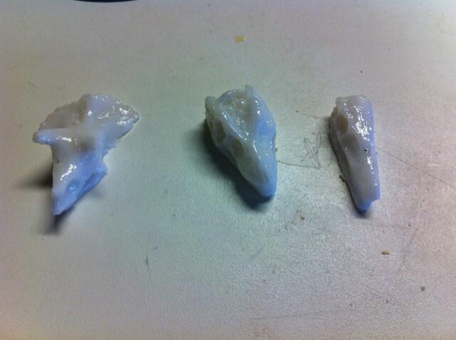

Hello. I am an apprentice neon bender who has been experimenting with other types of glasswork.
I'm trying to use freeze-and-fuse to make little dinosaur skulls from silicone molds I made myself. The ice cubes came out fine, but when I fired them according to this cycle (http://fusedglass.org/downloads/schedul ... hedule.pdf) they came out all slumped over on each other. These are made from System 96 recycled frit.
Is it the cycle I used? I didn't leave the ice cubes out to 'melt' either - some tutorials say that's important, others don't seem to stress it as very important. Some advice on both would be greatly appreciated.

I haven't done a lot of freeze-and-fuse but as far as I know, you're supposed to be using powder. You mention using recycled frit; is it ground to powder consistency?

It's pretty thin and seemed to take a good mold when I demolded it. (Sadly, did not take pictures of the ice cubes.) There was some crumbling when I demolded, but it wasn't the dramatic splattering/collapsing of the final product.
Here's a picture of the leftover frit I pounded down.

I've done a lot of FnF and if you use anything other than powder for small things, you are going to have problems most of the time. The power packs down very tight together and doesn't pull apart when it shrinks down during firing where the fine and bigger do not pack in tight. You can get away with using fine with powder in larger pieces. I've done this with several large object (over 1 pound of frit in size) by using fine in the middle with the power surrounding it. I didn't mix the two, but placed it dry on top of a layer of powder then I put powder on top of the fine and wet it all down.
I do it both ways after I pop them from the molds. I'll fuse them right away and sometimes I've left them over night sitting on the tray. They are fine as long as you don't touch them. If they are thawed and you touch them, they collapse into a file of powder (looks really neat too). You don't want to leave them in the freezer any longer than necessary though or they dry out and have problems coming out of the molds. I also use a lot of ice cube trays.

Interesting and depressing at the same time, because I don't have any powder frit on me.
But it's good to know what the cause was, and that it wasn't the firing cycle. I don't know nearly enough about the science and theory to even begin to figure them out on my own.

Thanks guys. You were right, it was the frit size. This new batch came out awesome.
