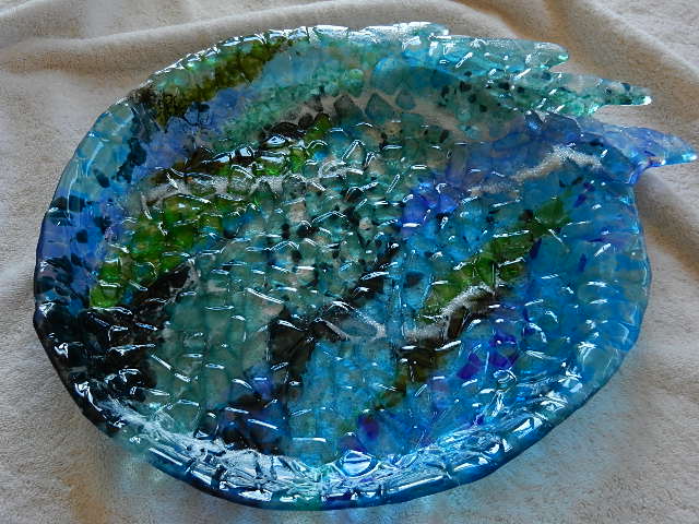

Water off Belize
Post by Terry Rothwell »
Inspired by the waters between San Pedro Island and the second longest reef in the world.

I love what you've done with texture and the rim is lovely. Are the darker lines done on a base piece under the textured area or is it an all-at-once thing? Very imaginative!

This was done on a full piece of Tekta with all the colors placed on top. Colors were done with frit and powders in 3 firings to create depth. Clear pieces were then tack fused to maintain the soft texture. A final tack fuse was used for the white "foam". Thanks for the kind words.
