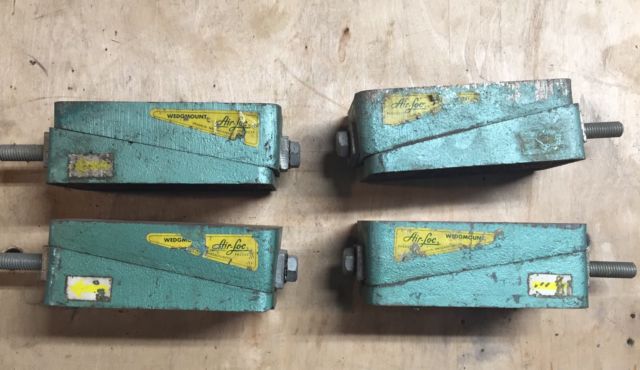

it just might be easier to level the kiln by putting shims under the legs. shims are triangular, so by moving them in and out, you can adjust the level of the kiln shelf.Luiza wrote:The shinkage/expansion of the clay during the process of heating/cooling the kiln would not move the shelf? I have a big level problem, about 5mm...Kevin Midgley wrote: Leveling shelves can also be done by placing a small ball of moist clay on the top or bottom of your kiln posts and carefully placing the kiln shelf on top of the posts. Press gently on the shelf until level.
Kevin
Luiza
- Posts: 155
Re: kiln floor repair
Triangular shims naturally want to scoot out if there is movement of the kiln, since they are an incline. Screw levelers are much better. For larger kilns I'd suggest machine leveling jacks - two triangle put face to face so they form two horizontal and parallel surfaces - a screw running through them means you can tighten/loosen the screw to move the one against the other but the outer surfaces are always parallel. And they can be adjusted to the finest degree. I worked in tool & die for many years and that is how it's done in industry. Google "machine leveling jacks wedge". Biggest problem you will have is finding smaller ones, the big ones are pricey but then again, they are made to hold up thousands of pounds each
. Used ones are just fine, there is nothing to wear out. I saw this set of 4 on ebay for $60.
