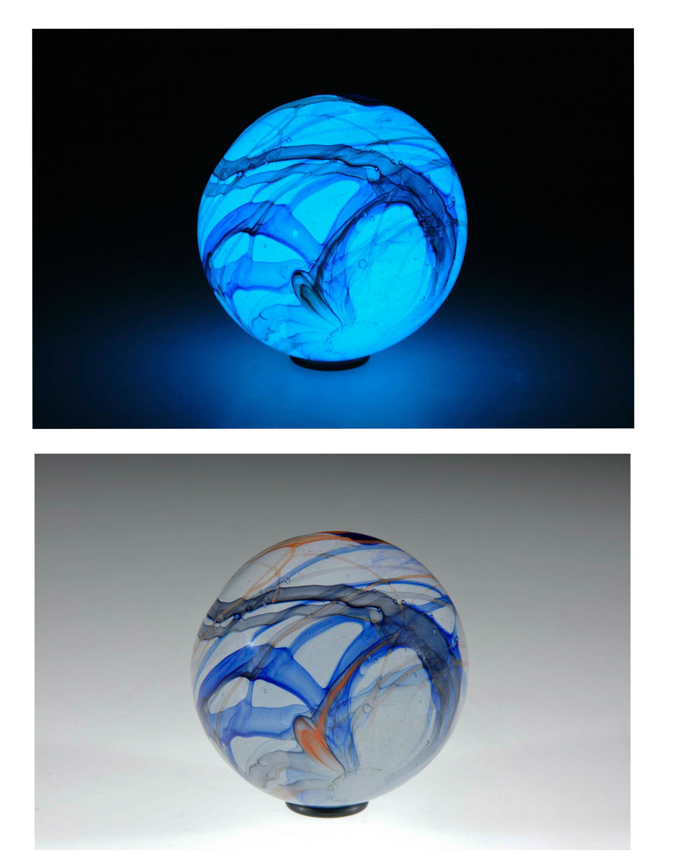

Here is an example of using them in a blown form - this is a marble that is about 3.0" in diameter. The top image is the marble glowing in the dark, the bottom is what it looks like in daylight. If I "charge" it outside in the sunlight for about 10 minutes or so, it will glow like this brightly for a few hours, and then slowing lose the glow after about 5-6 hours.

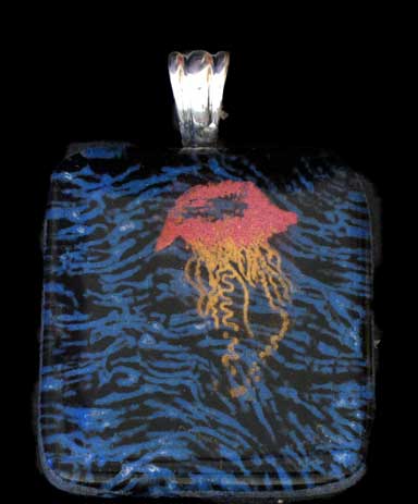

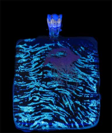

I mixed the powder with Ferro Flux and A-14 to get a screen printable paint.
In Regular light
In UV to charge the glow powder
