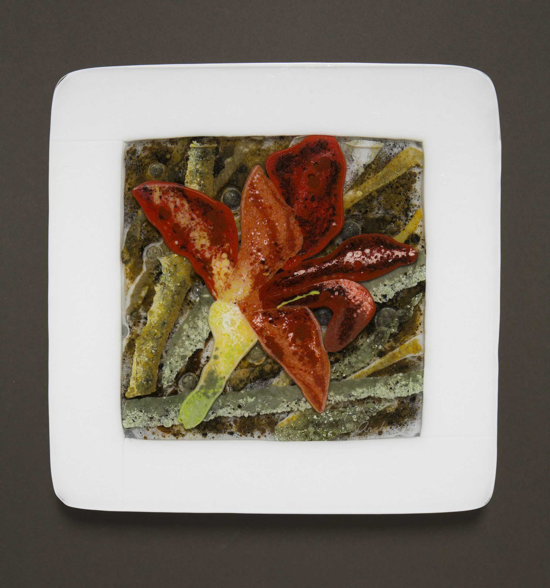

   click on image to enlarge
I also use photoshop in my work. I use it to de-pixilate the colors, so that rather than 25 million that your eye can see maybe you have just 200 for your glass image. Mix your frits in varying ratios, (1/8 etc) melt , crush and voila, new colors. layer frit on both sides on clear thin, down side the frit will be trapped by the clear and will retain sharp edges, upside the frit will spread a little. Most of my paintings have 5-6 layers done this way.
you can see them @ http://www.melarcher.com
