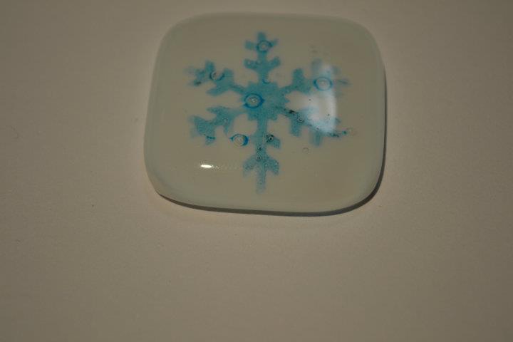

You can achieve a very pale blue / turquoise using copper leaf on reactive cloud. It is delicate and pale and I don't know how you'd get it on the interface between two pieces of glass (although now you've got me thinking!).

Copper leaf between reactive cloud and regular clear will turn react with the reactive cloud and turn brownish-reddish. Copper leaf will turn blue when sandwiched between any two glasses, so long as neither of the the two is a reactive or a selenium glass. But this blue color is NOT a reaction, it's just the color of the copper left behind when the leaf burns away.Kim Manley wrote:You can achieve a very pale blue / turquoise using copper leaf on reactive cloud. It is delicate and pale and I don't know how you'd get it on the interface between two pieces of glass (although now you've got me thinking!).

Are you positive what you are looking for is a reaction?
Could it be from super fine/powdered frit?
When I lay powder directly onto thinfire, then put large frit on top of that, then cap with clear and do a tack fuse the result looks a lot like a reaction (from the top side) with the powder color forming 'halos' around the larger frit.
