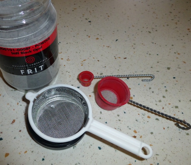

I've only got a few strainers of different sizes, along with an old toddler-sized spoon I use for scooping. I scoop with the spoon, then tap it smartly against my drafting table's edge to remove most of the powder, then wipe it with a designated cloth, which I change frequently. Never thought of dipping it in water, though. I just smack the strainers until I feel they can't hold any (or much!) residue.
I set the jar lid upside down, place my strainer in it, and then spoon powder into the strainer, so any extra powder is captured in the lid and therefore easy to pour back into the jar. When I'm applying powder to glass, I keep a large piece of card stock under my glass so I can retrieve the excess powder as I go. Since I typically work in only a few colors at a time, I can then salvage the extra powder and store it in mixed jars labeled "warm" or "cool." I'll use these "grab bag" mixed powders now and then when I want a pinch of random color.
As with everyone else, I only open a few jars at a time, and keep them separated. I had heavy-duty drawers built to store my 1-pound jars so I've labeled each lid with a white paint marker since I need to identify them from the top.
One of my very best strainers is a flat bottomed round strainer that fits the lids perfectly, purchased at the Japanese Dollar Store.

I keep trying to buy them again but haven't had any luck either!seachange wrote:Have been trying to get the japanese flat strainers Valerie mentioned, but no luck till now.
Re: powders-good studio practice-avoiding contamination
They're actually enamel sieves, so if you look at enameling supply centers you'll usually find them:
http://www.enameling.com/Screen,_sift.html
Our local ceramics supply house sometimes carries them, and whenever they do I usually buy up the entire supply. I go through those things like powder through a sieve.

SCORE! I was in Berkeley Sunday and stopped at Diaso. They had eight sifters so I bought all of them, at a buck-fifty each.
The guy at the register told me they'll order stuff if you've got the barcode, which I do. Let me know if anyone's interested and I'll send it.

The way the twisted handle sifters work, is you can rub your finger nail over the bumps and get the powder to fall through.Valerie Adams wrote:I have the enamel sifters and like them, but for large fields of powder, I LOVE my Japanese sifter. All is says on it is Made in Japan. I wish I would've bought several when I paid a buck for this one but I'll continue looking in my travels. Here, you can see it sitting in the jar lid:
When I worked with Thompson Enamel, I would save all the random powders that I knocked off or otherwise didn't use. I mixed them all together and fired it to see what it looked like. The cobalt blue sort of took over and it turned a pretty ugly gray color. The metal enamelists do this and use it as a counter enamel. They coat the back side of a piece with the glass frit, to equalize the expansion/contraction forces.
