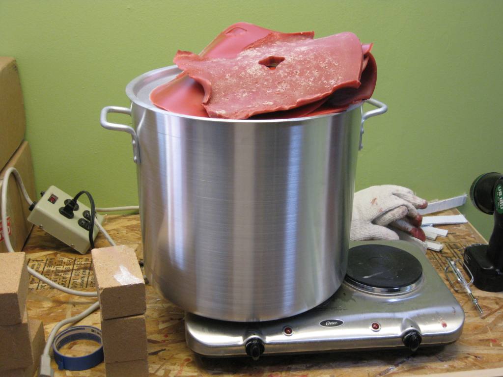

Put a couple inches of water in a pan, place your mold above the water using something like shelf posts, boild the water and steam out the wax. I like using a big pot with a lid. Some people fill with glass at this time and include their drying schedule in the ramp up. I prefer to dry my mold and burn out the wax before I fill the mold with glass. I have a friend who uses an old barbque and places his big pan of water on that and closes the lid while the wax steams out.

Glass Hole's method works well, although it helps to direct the steam to the wax and not to the whole mold if you're removing a lot of wax. Otherwise, you risk saturating the plaster and turning it soupy, which can weaken the mold, cause loss of detail and sometimes makes the surface of your glass scummy.
I started out steaming by buying an old used spaghetti pot at the Goodwill. It worked well for smaller pieces.
For bigger pieces (that wouldn't fit in the pot, which was most of them), I drilled a hole in the lid, got heat-resistant tubing (actually, I found an old clothing steamer hose at the Goodwill), and pushed it through the hole. I filled the pot with water, put the lid+hose on the pot and duct-taped the entire assembly together. Then I bought two big galvanized washtubs and a stainless steel rack salvaged from an old oven. I put the rack on the first washtub, put the mold on it, stuck the hose in the mold and then covered the whole thing with the second washtub. Steamed the wax out pretty quickly without messing up the mold. The wax drips down into the bottom tub; if you put a little water in the tub before you start it never sticks and is fairly easy to remove.
Now I've got an old wallpaper steamer (also bought at Goodwill for about $15) that I use in place of the spaghetti pot.
