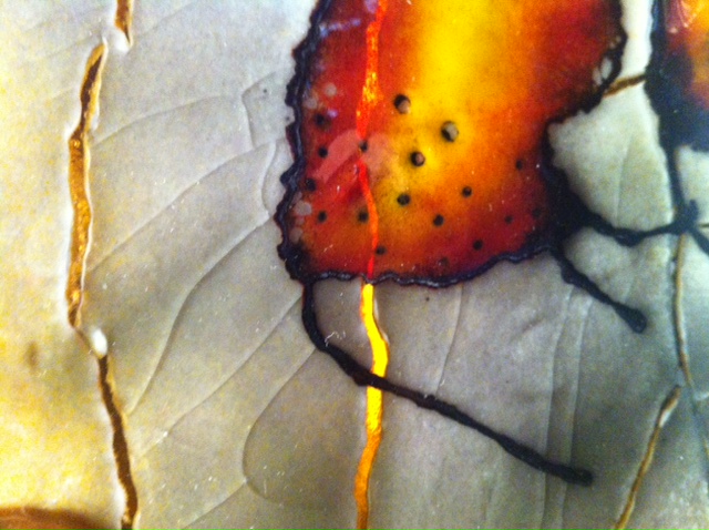

Thanks for the compliments! Here is a close up of the cracks.
The cracks are only on one side of the piece, they do not transfer to the backside (medium amber) YET! The cracks are only on the side with the crackle; French Vanilla powder 20%, Opaque white powder 40%, white opal 40% (all are newly purchase glass) and a slash of marigold, orange, yellow and oregon grey.

Babette: It sure looks and sounds like incompatibility with white. Nice piece. You could try blast away the cracks if they aren't all the way through, and pumice. Or cut up the piece in sections and re-assemble leaving out the cracked areas.

I still think it would be a super idea to take some of the offending glass, put on 1101 30 bullseye, fire with your schedule , and then check under polorized film. You will get your answer. P.S. try upside down on fiber toooo just how you also created the piece.

Thank you everyone for the suggestions. I am working on finding out what went wrong but so far it is looking like it is an incompatibility problem. I have been talking with Bullseye and I think they are also running some tests. I just did a new piece with everything the same except no WHITE powders, I substituted opaline for the white powder and the piece is crack free! I will keep you posted because if there is a problem with their formula everyone should be careful how they use white. To be honest it would be better if I did do something wrong, it would we easier to change a schedule than to change my use of white powders...so I'm addicted to white powder am I? :shock:
The cracked piece still appears to be stable, the cracks are only on the surface where I used the white powders, they have not transmitted through to the back of the glass. I will keep it as it is, it looks as good as it can but any glass person will see the cracks as a fault and a non glass person might think it was meant to be or just the nature of the material...it kinda looks like the crazing you get on pottery.

White is slow to absorb heat. COE is a whole range of factors and while you cooked your glass at high temperature, the white could very well have been considerably cooler /experiencing less of that heatwork. If you had annealed the piece for say twice the time and over a greater range of temperatures than is normally acceptable practise, you might have been able to pull it off without the cracks.
I stress might have been able to.
Another factor in the white thing is that as a powder, the white along with being a heat reflective colour as compared to say black, would also have all the micro air bubbles between the granules further insulating and slowing the heat energy transfer. Visualize the white powder as a block of insulation stuck in the middle of your art work.
If you also fired at lower top temperatures for a longer period of time to equate to the necessary heat work, that might have reduced the high temperature volatization of the trace COE changing chemicals being lost to the air inside the kiln.
Less loss = less COE change.

I got an email response from bullseye today:
"Our technicians have had a chance to look over all of the information related to the cracking in your pieces, and to do some testing with the 0013 powder. They’ve determined that what you’re experiencing is the exact same type of cracks that appear in the 0013 powder when it’s sandwiched between 2 layers of glass-the issue addressed in the warning label on all jars of this powder so people can either avoid or encourage it depending on their goals.
This is the first time we’ve seen the Opaque White powder behave like this when it isn’t between layers of sheet glass but testing showed that you’re building up enough of the powder on the fiber paper to essentially act as another layer of glass, causing the tiny, harmless cracks. These won’t continue to develop or cause residual stress in the final piece.
There was a general consensus that the extra cracking adds another layer of design dimension to the work and that it looks good with your design, but if you want to avoid the cracks you’ll just need to use the 0113 White or other powder. We always recommend running a test before committing to making a large work and strongly suggest doing chip tests whenever mixing powder colors together.
I hope this is helpful! Please let me know if you have more questions and thank you for your patience as we worked on getting you an answer."
__________________________________________________________________________________________________________
But isn't a crack a CRACK and it means there is something wrong? It sounds like incompatible glass, incompatible with one firing to no higher than F 1500? Plus this cracking is new and just started happening with the recent batch of purchased glass.
